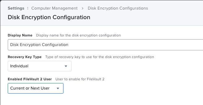

@ScottSimmons Technically don't need a policy. If you have the Config Profile configured the way you do, but check "Require FV2" - it enables at the next log out without a policy.
  • Feb 24, 2020 1:23 AM UTC
Looks like it's working for us now with Catalina 15.3, mobile accounts and bootstrap token.
Policy: Enable FV at login.

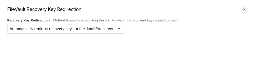

Config Profile: Escrow key (and enforce FV but only if it's enabled already otherwise you get a logout/login conflict)
I've found that it Escrow's the key anyway if deployed via Policy but you want the profile applied for any future key changes (if they become unknown or invalid in Jamf).
I've found that if you log in with the AD account (standard user) then do something like sudo fdesetup list or status in Terminal, which involves switching user in terminal to the local admin account su localadminaccount the local admin account then gets a secureToken and the mobile account can't enable FV without the local admin account granting it a secureToken first.
If you never do su localadmin in Terminal, the local account never gets a secureToken, and the Bootstrap is granted to the mobile account when the mobile account is prompted to encrypt at login (as no other token holders exist).
Also found that deploying FV at logout via the Config Profile displays the Individual Recovery Key to the end user (not ideal) and as mentioned above encryption is deferred until they do a logout. Shutdown/Restart won't enable it. This doesn't happen when deploying via Policy and users can shutdown/restart and they'll prompted to encrypt the next time they log in.

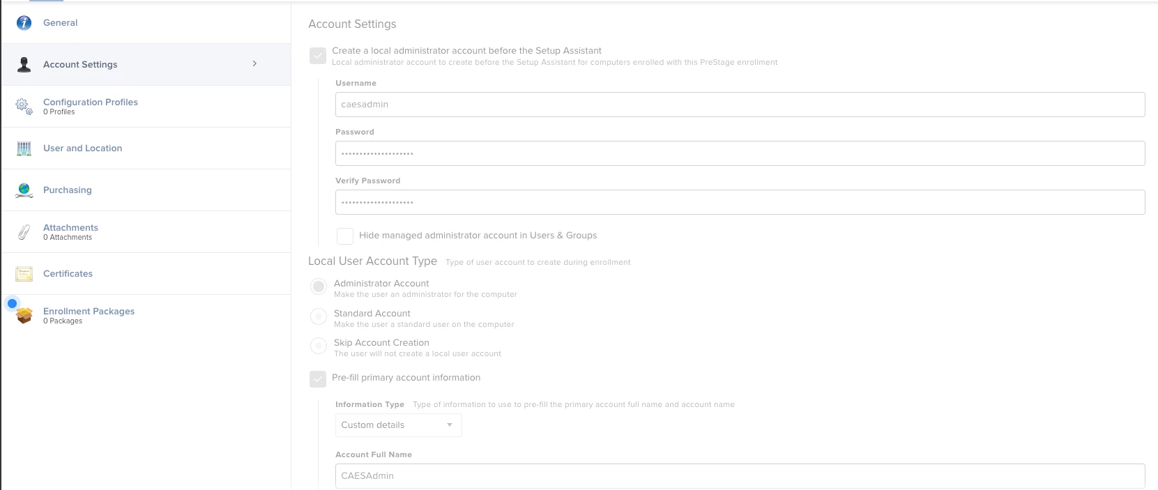

@ScottSimmons We have all of our tech setup all Macs before deploying as well. You know if we can add these during enrollment?

Am I reading correctly that in order for FV to enable at next login via policy, the account created in PreStage enrollment must have the following:
-Create Account before Setup Assistant
-Hide account
-Local User Account type: Administrator
Once this is done, a policy can be generated to enable FV at next login, correct?
Ideal solution is FV enables at next login and bootstrap token is enabled.
  • Mar 1, 2020 10:51 PM UTC
@kevin.v Our PreStage enrollment account isn't hidden and it still works. The real difference is whether you log in (or switch user in Terminal) to that local admin account.
If you log in with it (first login), it will get a secureToken, and in that case you'll need a policy that will use its admin credentials to grant a token to the next (mobile account) user. If your local admin account created in PreStage Enrollment never logs in (which is our case as we're trying to actually make zero-touch deployments a reality) then the mobile account receives the secureToken when they are prompted to enable it at their next login (as no other token holders exist).

@ kevin.v
If you setup the prestage as per my image, bootstrap toen will function for any mobile account . The admin A/C doesn't need to be hidden.

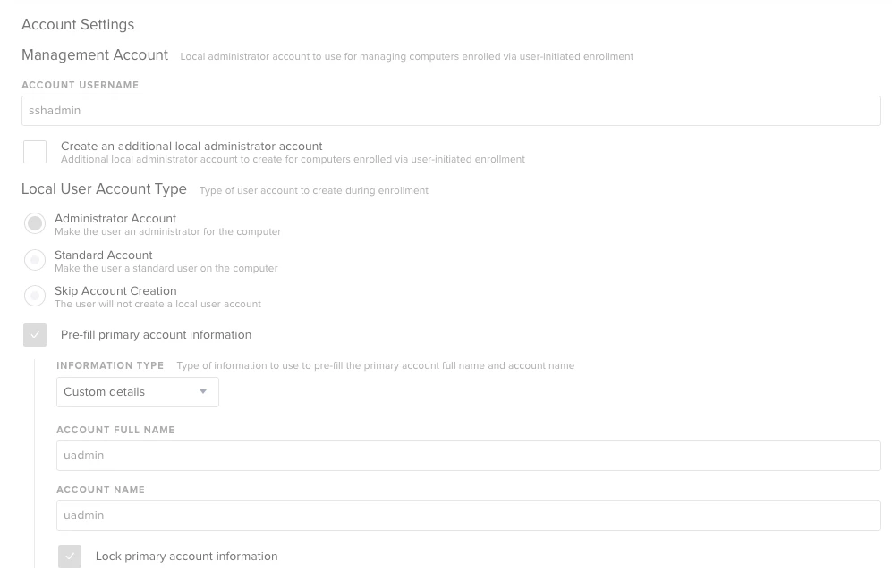

@kerouak What flavor of JSS? We're on 10.19, your PSE window looks slightly different:
