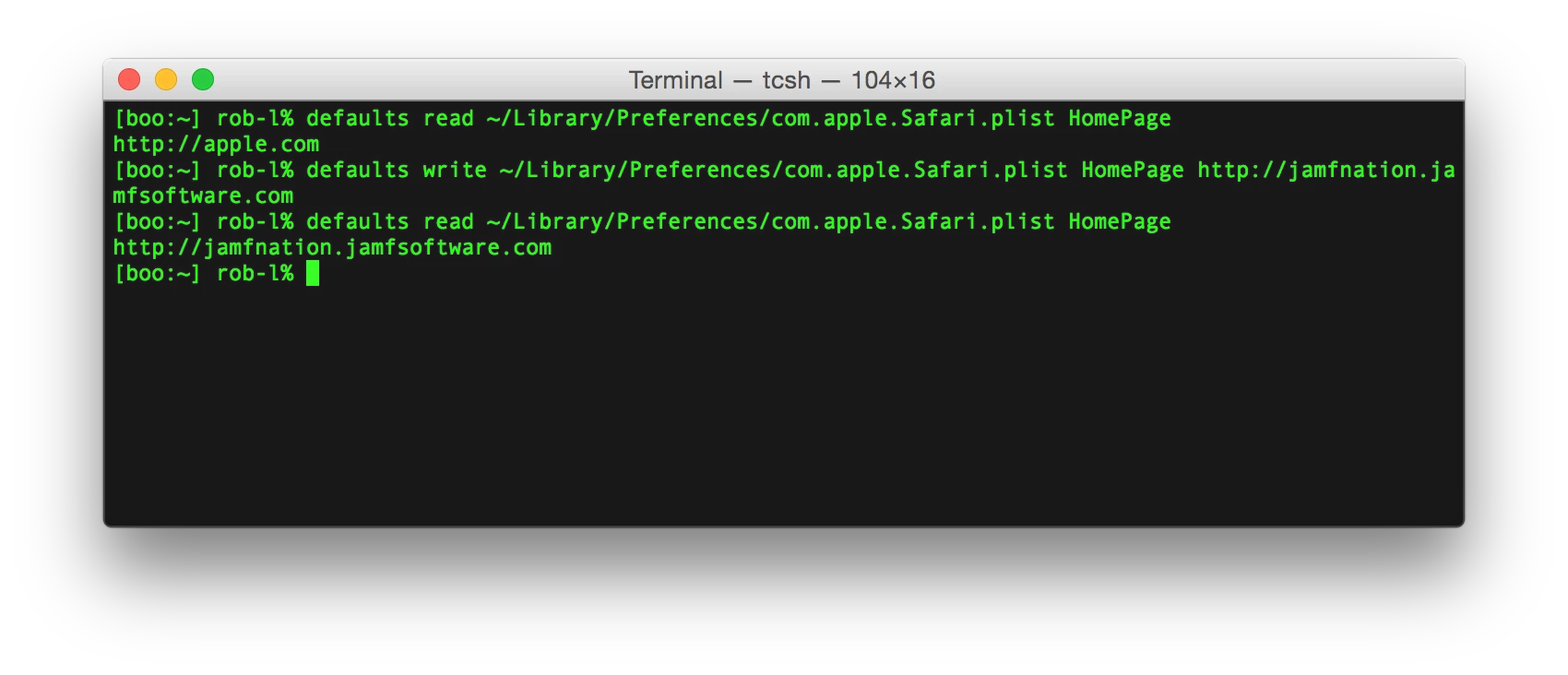

So I'm not sure where the Google Chrome preferences are but it shouldn't be hard to find them but Safari stores it's preferences in ~/Library/Preferences/com.apple.Safari.plist
So what you can do is a defaults write command into that plist to change the value.
Below is my terminal output showing the following:
My first command was my initial defaults read command to check in ~/Library/Preferences/com.apple.Safari.plist what the current value of the key 'HomePage' is set to. In this case, http://apple.com
The 2nd command is me performing a defaults write command into the file ~/Library/Preferences/com.apple.Safari.plist saying that for the Key value 'HomePage' write the value to be 'http://jamfnation.jamfsoftware.com'
My 3rd line was just a repeat of the defaults read to make sure the write command ran correctly.
You should be able to do something similar with the Google Chrome plist.
Hope that helps.
Rob
