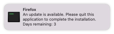

Are there any screenshots of what these notifications for reminders and deadlines will ultimately look like?
 This is an example of the default notification, with no deadline set
 Here is an example with a deadline set (it now has a countdown timer to notify how long until the deadline). It says minutes in this case as we set a deadline of 1 minute for this example. We would expect that most deadlines would be a number of days, in which case it would countdown in the number of days remaining.
 Finally an example of the notification once a deadline has been reached.
