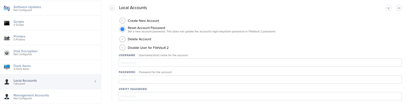

Hi @angelofilho33 Is the admin account identical on all the machines? If so, you could use a policy payload to do this rather then creating a script
Sorry for the delay to reply. I created a policy, the way Nong did and everything went well. Thanks Nong. Thanks Glover
