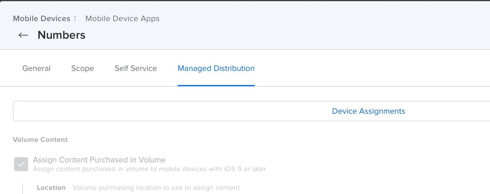

In Jamf, did you check off the box to "Assign Content Purchased in Volume"?
Yep it was already checked
