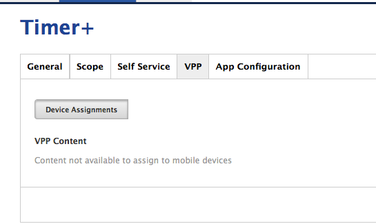

I have noticed a couple of apps will not get the check box under the VPP tab for device assignment. This morning I purchased 6 apps from the VPP site, and 5 of them worked perfectly but 1 of them still will not show the device assignment check box.
Is this something that maybe the developer hasn't enabled?

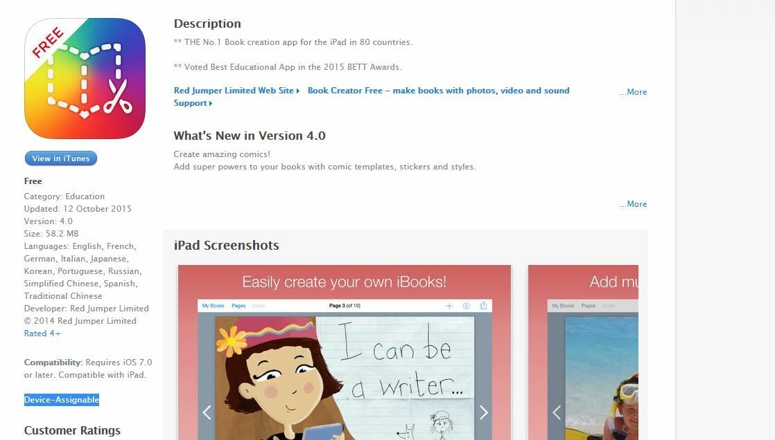

Yep, this is something the developer needs to enable. You can check if an app is Device Assignable by going to the VPP site and searching for the app. Down the left hand side below the app Icon it will say "Device-Assignable". See picture attached also.
Edit: Just been scrolling through some other discussions. You also have to make sure you purchase the app as Managed Distribution codes and NOT redeemable codes.

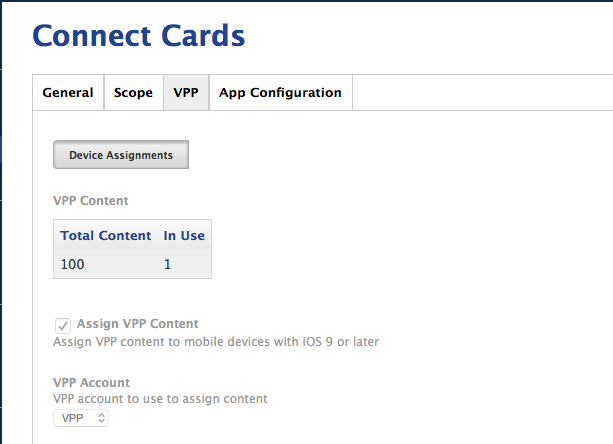

It looks like all the apps that I'm trying to assign to devices are set up for device assignment. Thank you though I did not know that information could be found there. I did see however that one app I was having trouble with last week is working now. This is just strange because because I purchased the codes back on the 12th and another app that I purchased the same day isn't working Is there possibly a slow sync between my JSS and VPP?
Timer+ in our JSS:

Connect Cards in our JSS (purchased at the same time as Timer+):
