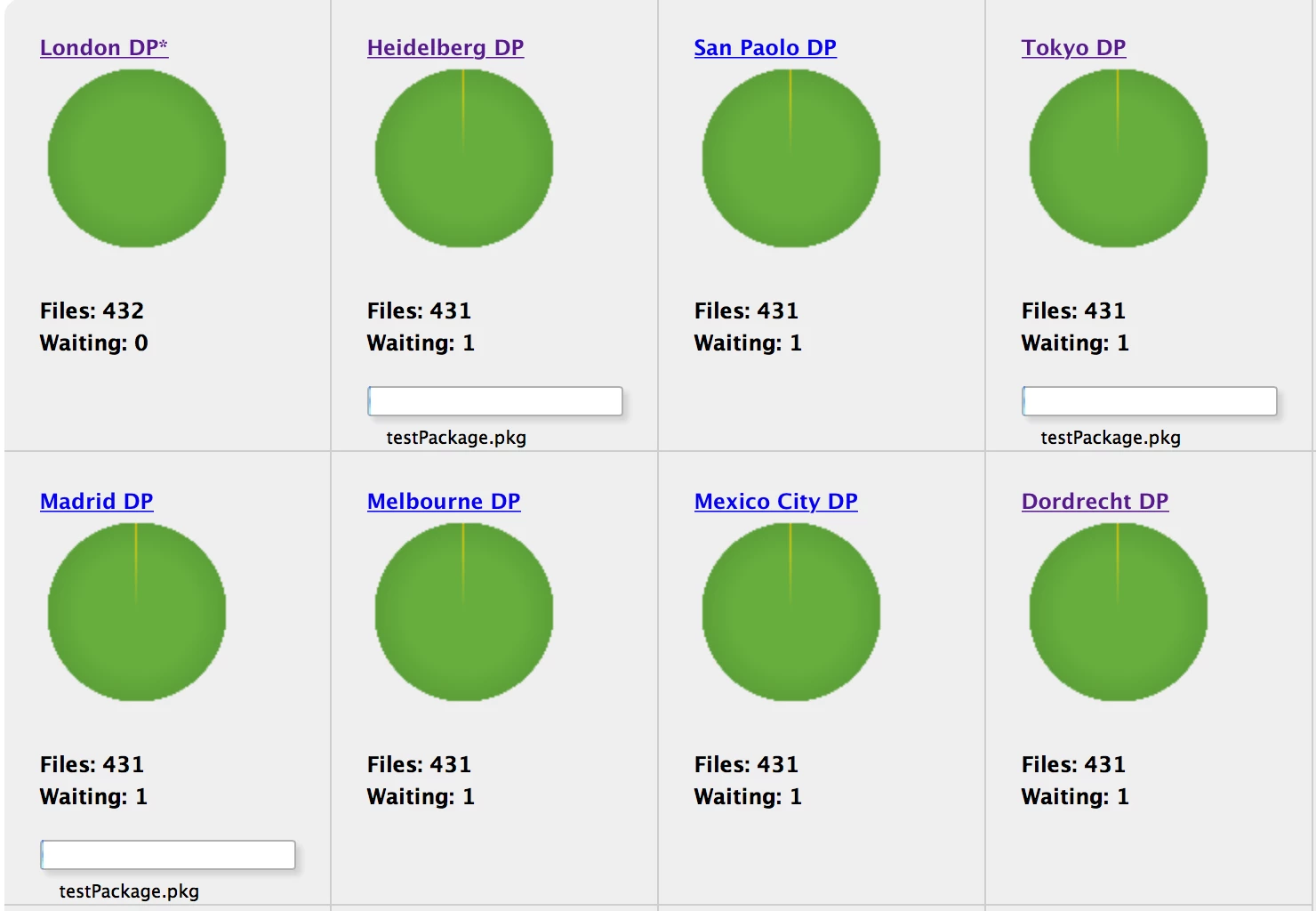

Hi,
I'm having an issue with JDS where by it will not copy new packages across all JDS DPs.
I have tried lots of things:
- checked connectivity between JSS and the JDS
- checked connectivity between master JDS and a child JDS
- checked DNS wasn't an issue
- Ran inventory on each JDS - Restarted the JDS instances
- Changing master distribution point and uploading to that.
- Restarted tomcat service for jss incase there was anything on that side.
I can see that existing packages are replicating fine because i have a test jds server that i can use to select specific packages, which works. The problem is uploading new packages.
See the screenshot of the JDS dashboard. The package is visible to the servers but not is happening.
Please help!

Hi all, I tried 'SSLInsecureRenegotiation on' in jds.conf and a re-enroll. Both don't work.
This is a common entry in the logs:
2017-06-09 09:10:06,829 ERROR (60, 'server certificate verification failed. CAfile: /etc/ssl/certs/ca-certificates.crt CRLfile: none')
I've tried to update the ca-certificates package but it's on the latest version.
Also tried 'update-ca-certificates' to make sure trusted ca's were up-to-date.
This also happens on a couple of other instances, meaning I make them parent of certain child nodes and it does the same thing. Not sure what would have brought this on as this was working perfectly well around a week and a half ago when I last uploaded packages. There have not been software updates run on these servers that could have affected this.
