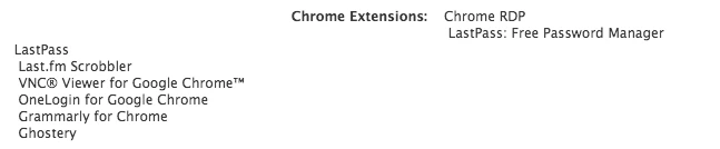

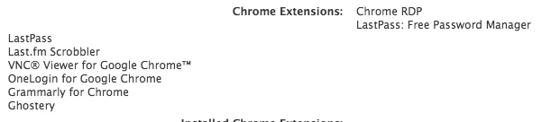

emily
  • May 26, 2016 7:17 PM UTC
I've been having trouble getting a few of these to work recently… not sure if it's because of JSS changes, Chrome changes, who knows what else… I managed to get @mm2270's working by changing how it gets the loggedinUser, but the display is kind of wonky:
loggedInUser=`python -c 'from SystemConfiguration import SCDynamicStoreCopyConsoleUser; import sys; username = (SCDynamicStoreCopyConsoleUser(None, None, None) or [None])[0]; username = [username,""][username in [u"loginwindow", None, u""]]; sys.stdout.write(username + "
JSONS=$( find "/Users/${loggedInUser}/Library/Application Support/Google/Chrome/Default/Extensions/" -maxdepth 4 -name "manifest.json" )
while read JSON; do
    NAME=$( awk -F'"' '/name/{print $4}' "$JSON" )
    if [[ ! -z "$NAME" ]] && [[ ! "$NAME" =~ "_MSG_" ]]; then
        EXTS+=( "${NAME}
done < <(echo "$JSONS")
echo "<result>$(echo -e "${EXTS[@]}")</result>"
Is there a way to control how the output is displayed? Nothing in the JSS's HTML screamed incorrect formatting to me, but I could be missing something in padding or floats. Any recommendations?
mm2270
  • May 26, 2016 7:30 PM UTC
@emily Try it this way. My script was written a while ago, before I started using printf for printing arrays, which produces much more reliable output. This one should work better:
while read JSON; do
        EXTS+=( "${NAME}" )
echo "<result>$(printf '%s
' "${EXTS[@]}")</result>"
mm2270
  • May 26, 2016 7:51 PM UTC
Oh, @emily Are you using JSS 9.92 by any chance? If so, take a look at @millersc's post here: https://jamfnation.jamfsoftware.com/discussion.html?id=19987#responseChild120571
I think that may explain the crux of the display issue you're seeing. We're not on 9.92 yet, so this was the first I'd seen of this. Oy.
emily
Better, but still not quite right.
At this point, I'm guessing it's more of a JSS web layout issue than an EA issue. Though nothing in the stylesheet really screamed out at me to cause the misalignment… hrm.
mm2270
  • May 26, 2016 8:16 PM UTC
Yeah, seems to be a bug/defect. See my post above with a link to a post on the issue on the JSS 9.92 thread. That's why I asked if you happened to be on that release? if so, it sounds exactly like the issue described there.

I posted a new EA the other day --
https://jamfnation.jamfsoftware.com/viewProductFile.html?fid=859
It may not be perfect, but you can contribute on GIT if you want
https://github.com/igeekjsc/JAMF-Extension-Attributes
  • May 27, 2016 1:38 PM UTC
My EA is a lot like @mm2270
But I do a little extra work to find out what the "__MSG" extensions really are.

elliotjordan
  • Jan 24, 2017 10:55 PM UTC
I wrote another flavor of the Chrome extensions EA, but this one allows you to specify failover locales (en, then en_US, then en_GB, etc.) and it also pulls the extension version.
https://gist.github.com/homebysix/da935f8f0ef88d7d4b6300ff14066ca6
Multi-line EA output is tricky to filter in a useful way, but at least this will give you the raw data to start from.
