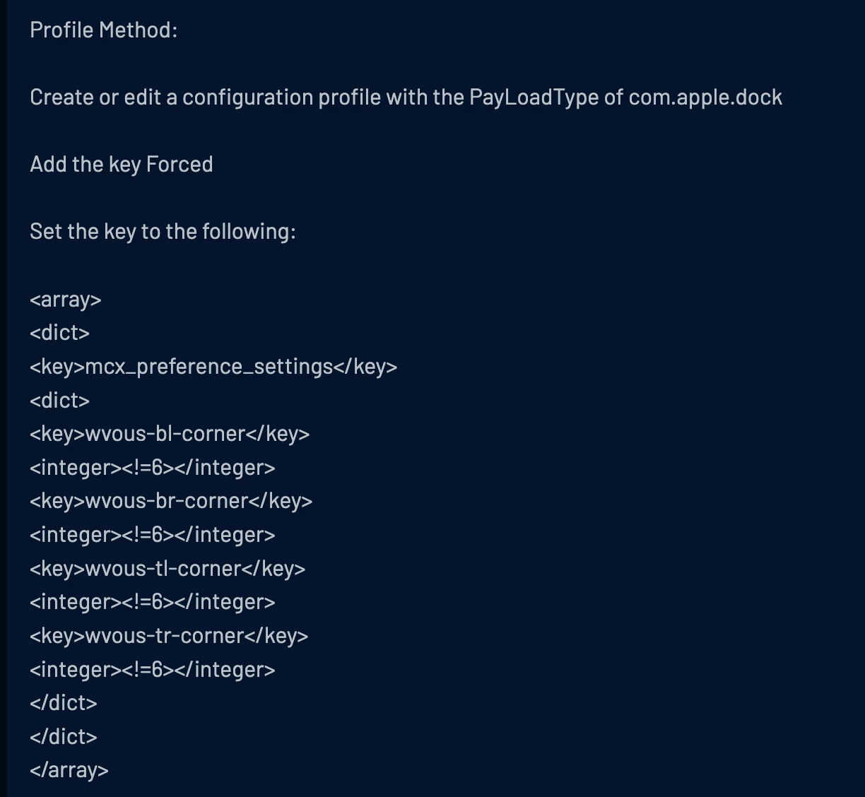

Both CIS and Tenable provide a configuration profile method to undo any hot corner set to disable screen saver.
CIS uses <≠6>
Tenable uses <!=6>
Neither seem to work. Anyone have any luck with this?

The way we've always done it is to monitor for corners that are set to 6, and set to 0.
It would be fantastic if this could be automated using a Configuration Profile some day.
Just took a look at both.
I think what you’re seeing are examples of how not to write documentation. They’re trying to to tell you “something other that 6” or “not 6”. I don’t think they intend you to use those as actual values.
Integers ≠ strings.

I’m not familiar with either of those management systems, but those values are not integers. They may be doing some proprietary magic on their end to make this work.
In my testing, setting the corner to the “ - “ in the dropdown list changes the plist value to “1”. I know of no way to disable a single property in a list of properties — just how to enforce a single property.

Yep, someone told me it's possible to undo a corner if it is set to 6 using a configuration profile and sent me the info, so I thought I'd give it a shot.
CIS
Tenable
Integers ≠ strings.
