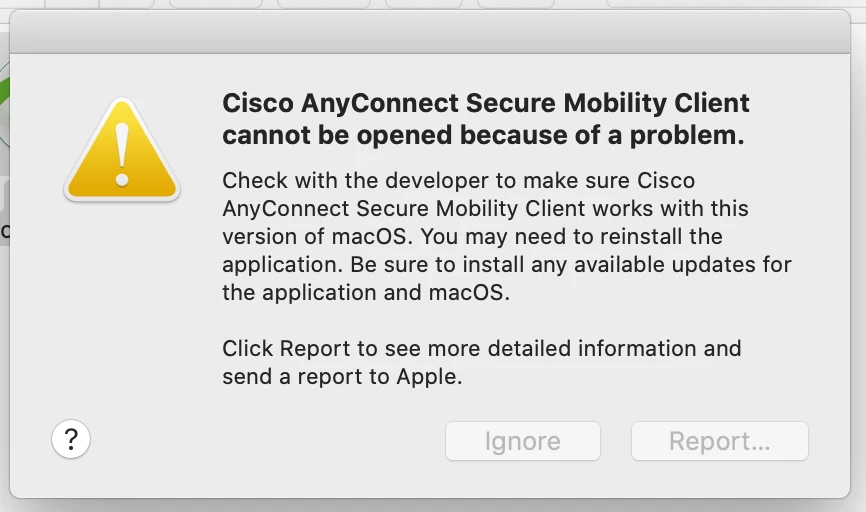

Hello
Does anyone had any issue with Cisco AnyConnect 4.8 deployment on Catalina?
So far I had no problem deploying this policy or previous versions on Mojave and below.
Manual installation works well.
I collected log files from installation process.
Appreciate any suggestion.
