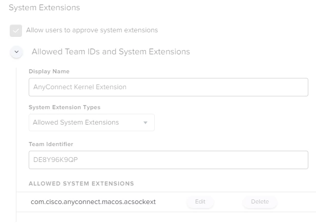

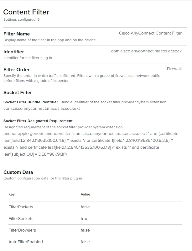

Did you approved the system extension? You need two different profiles (or one profile with two payloads) for Cisco AnyConnect. Also you need to pre-approve the system extension before you install Cisco AnyConnect.
Here we deploy two configuration profiles:
- System Extension (pre-approves the Cisco AnyConnect system extension)
- Content Filter (configures the socket to be used by the system extension)
Follow instructions here: AnyConnect macOS 11 Big Sur Advisory

Thank you for replying but it looks like you didn't see my screenshots of the payload that covers both. I also have that very link in my post.
...and yes, I'm painfully aware that the payload comes before the install. Hence my frustration with it since I have to remove the package, remove the payload and restart the machine when testing any changes to make sure the new payload is in place before I do the install.
