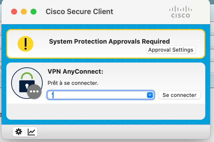

Recently, I have been experiencing issues with system permissions on macOS when using Cisco AnyConnect VPN.
Users are prompted to go to System Settings, then to the Privacy & Security settings. In many cases, they manage to find the required settings, but some users are unable to do so.

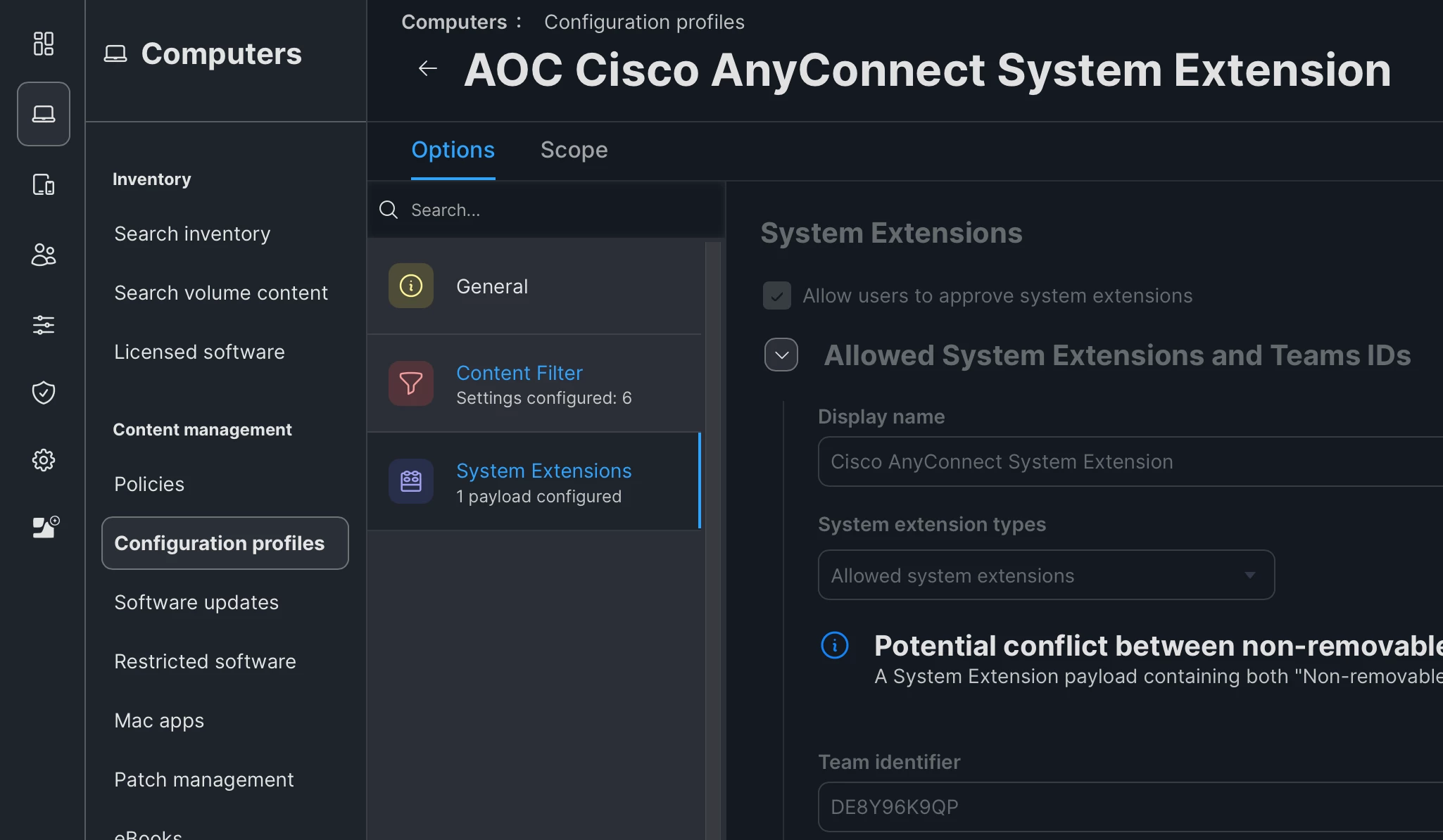

I have pushed a Configuration Profile, but it seems that it is no longer working.
This issue occurs with macOS 26 and Cisco AnyConnect client version 5.1.17.

Do you have a system extension scoped to these Macs in question?
LaurentCh
  • Sep 17, 2026 12:46 PM UTC
Yes i have

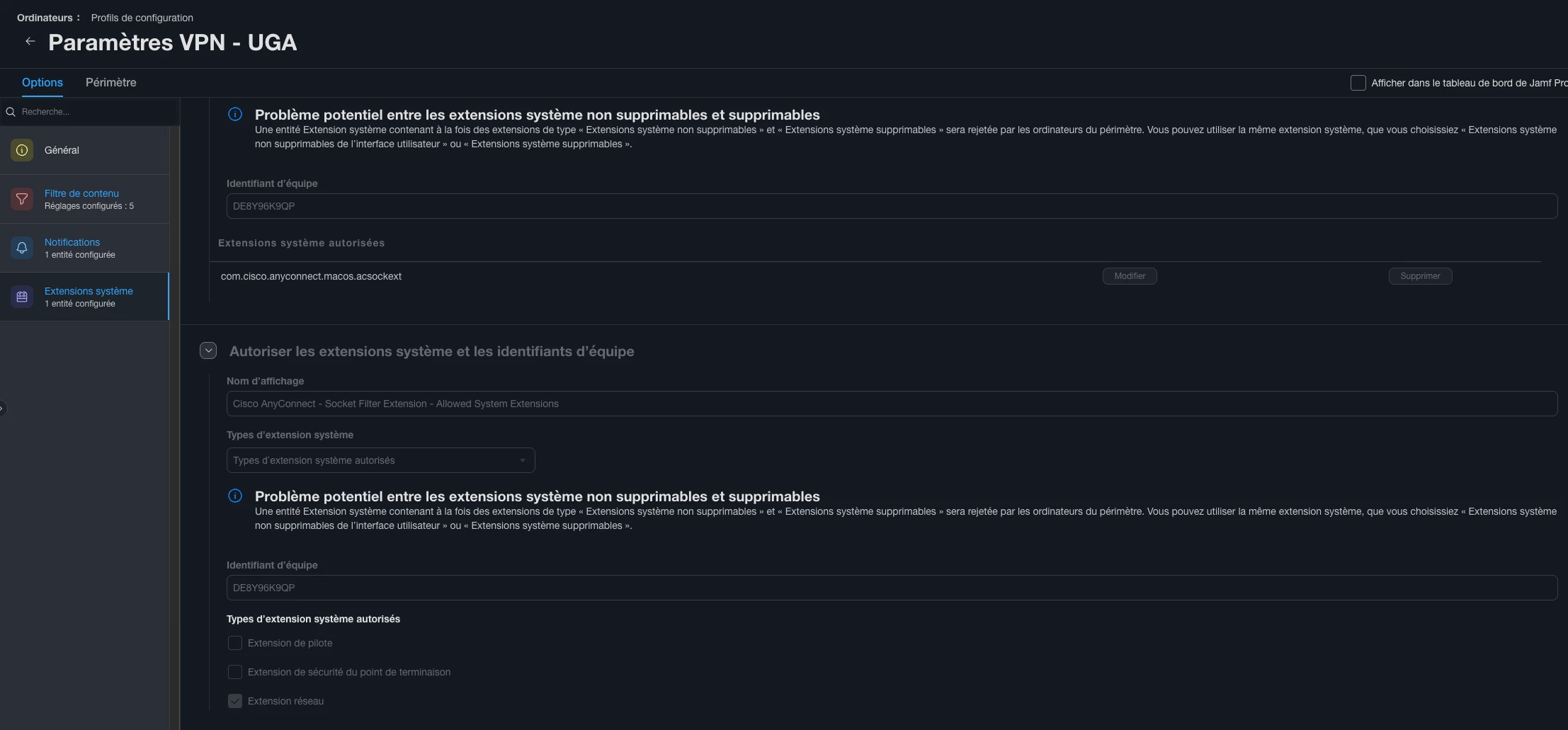

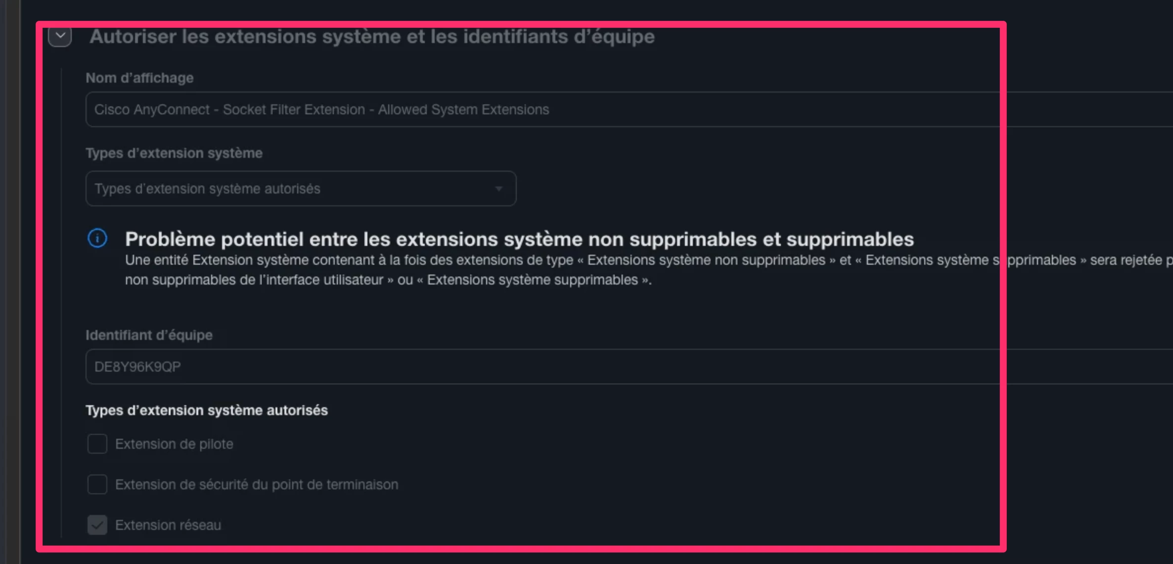

mvu
  • Sep 17, 2026 1:16 PM UTC
Wondering if the bottom half of your configuration profile is causing a conflict. The top half should do the job.
Are you able to clone this profile, delete the bottom-half, and test on a device or two?

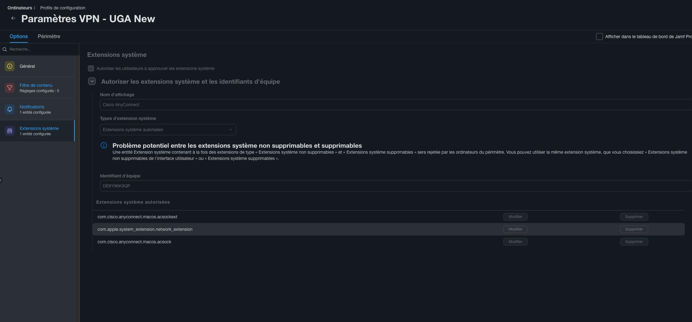

LaurentCh
  • Sep 17, 2026 1:28 PM UTC
Ok ​@mvu i’m going to remove the team identifier and the checked option and retry on my test mac
LaurentCh
  • Sep 17, 2026 2:10 PM UTC
I’v modified my configuration profile and difuse on my test computer, i don’t know if this is a hazard, but it works, this is how it is now.
I send it on other Mac i’m waiting for feedback
mvu
  • Sep 17, 2026 2:19 PM UTC
From what I undestand, the top part will provide proper coverage for the System Extenstion. The bottom half (in your previous configuration profile) may cause a conflict.
