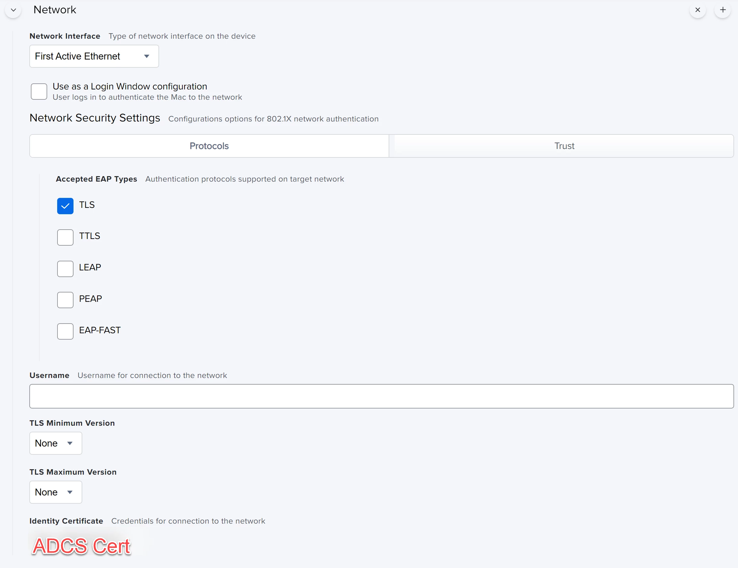

My Ethernet Config Profile
My Ethernet profile may once randomly auth properly then just fails time after time and I'm thinking I have the wired setup all wrong. When authenticating ISE reaches out to Jamf with the MAC address of the USB Hub connected to the Mac and it fails device compliance stating the device is not found in Jamf and to register.
The failures, return a MDM.MDM-GUID:MacAddress of the USB Hub VS a successful auth has this value MDM.MDM-GUID: empty. Instead the mac address of the USB Hub is in the MDM.macaddress=MacAddress and the mdm.UDID=UDIDofMac is looked up properly with the mac marked as compliant. I'm not sure what I'm doing wrong. I had this working before on wired, but after we renewed one of our certificates and purged the device cache from ISE the Wired policy almost never works.
I attribute part of the failure to the USB Hub mac address technically not being in Jamf. But it's supposed to look up against the UDID? Wireless works every time as that MAC Address is in Jamf and it can find the device directly no problem. What am I doing wrong?

Hey Mojo,
I've recreated the profile and Wireless is still succeeding however Wired continues to fail. It seems no matter if I change the ethernet to Any, First Connected it seems to get stuck on the MAC Address of the ethernet adapter and it's not looking up the Mac in Jamf against the UDID in Jamf and GUID in the SAN of the ADCS Cert. At first we started with wired authentication and it was working as intended, Jamf would return the UDID, Compliance and MAC of the adapter to ISE and authenticate through. I do not have the Mac's in AD, even just as fake accounts but that might be something I can try.
Do you mind if I ask how you are setting your ethernet policy? Are you using First Connected or Any connected ethernet?

Hey Mojo,
We are using First Active Ethernet.
Good to know. I think for right now the ISE configuration profile is good but ISE is not looking at the GUID when it gets the response from Jamf and only goes off the MAC of the USB Hub which is the real problem I believe. Even with an EA to capture the USB Hub's MAC, ISE has no way to look at it.
