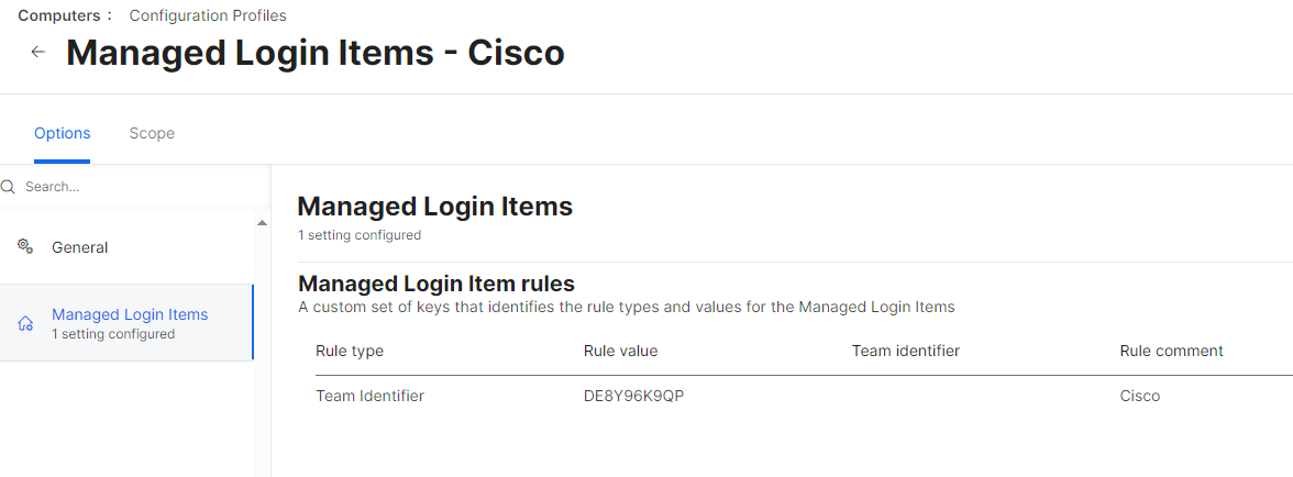

Looks like you need to make a
Managed Login Items for cisco

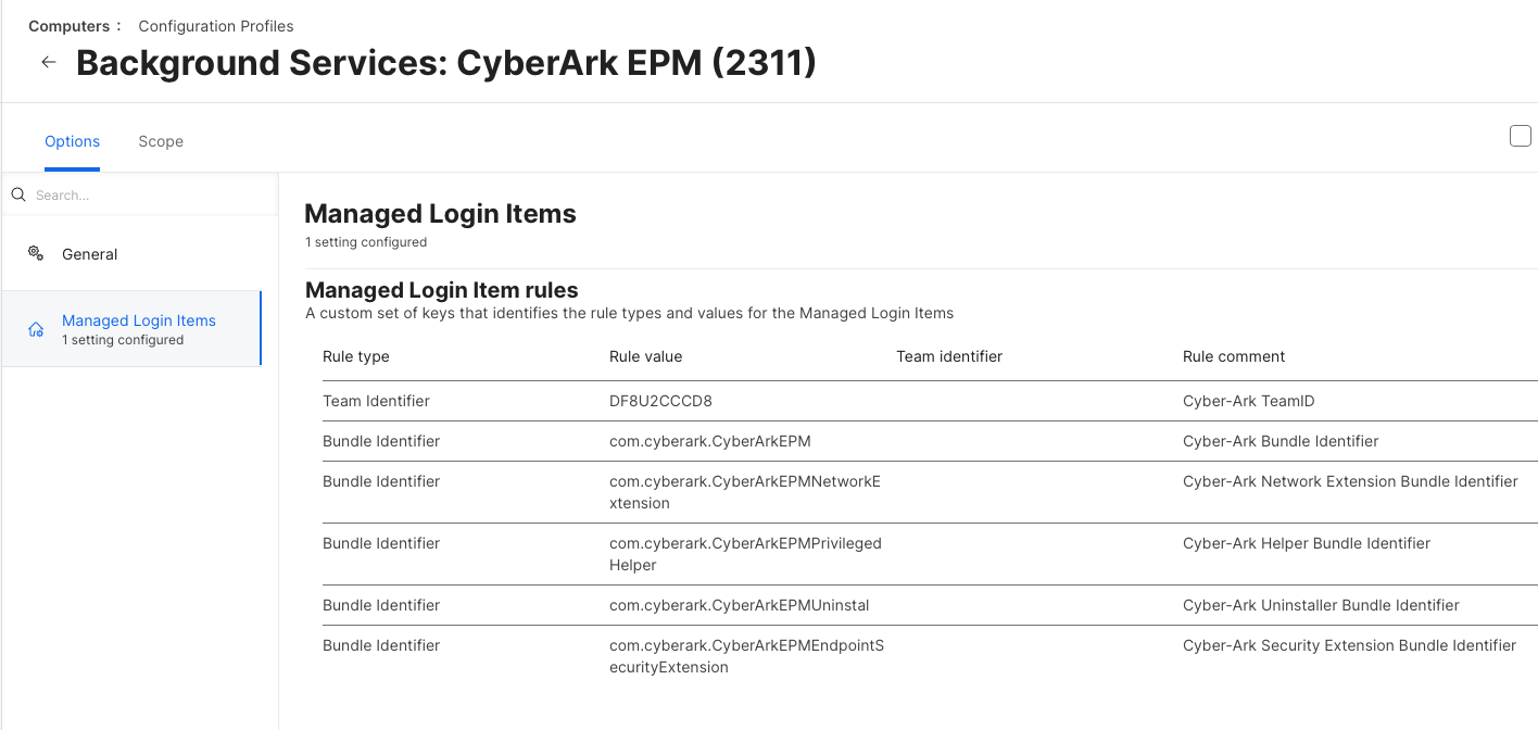

The name displayed in that field is what Cisco wants it to be, not necessarily what it actually is. Cisco should have the documentation you need to get this approved. However, Cisco is also pretty well known for being beyond half effort with macOS.
This is not a System Extension, it's a Background Service. You need to force enable the Background Service, or Managed Login Item as it's called in MDM. Below is an example of a configuration profile that would enable this toggle for an application called Cyber-Ark EPM. The general principle is the same for any Background Service approval.
https://support.apple.com/guide/deployment/managed-login-items-payload-settings-dep07b92494/web
https://support.apple.com/guide/deployment/manage-login-items-background-tasks-mac-depdca572563/web
Wow, yup that was it. Simple. I can't believe that step was missing from Cisco's Deployment docs. I just had to add the team id and the bundle id and boom. Thanks a ton!

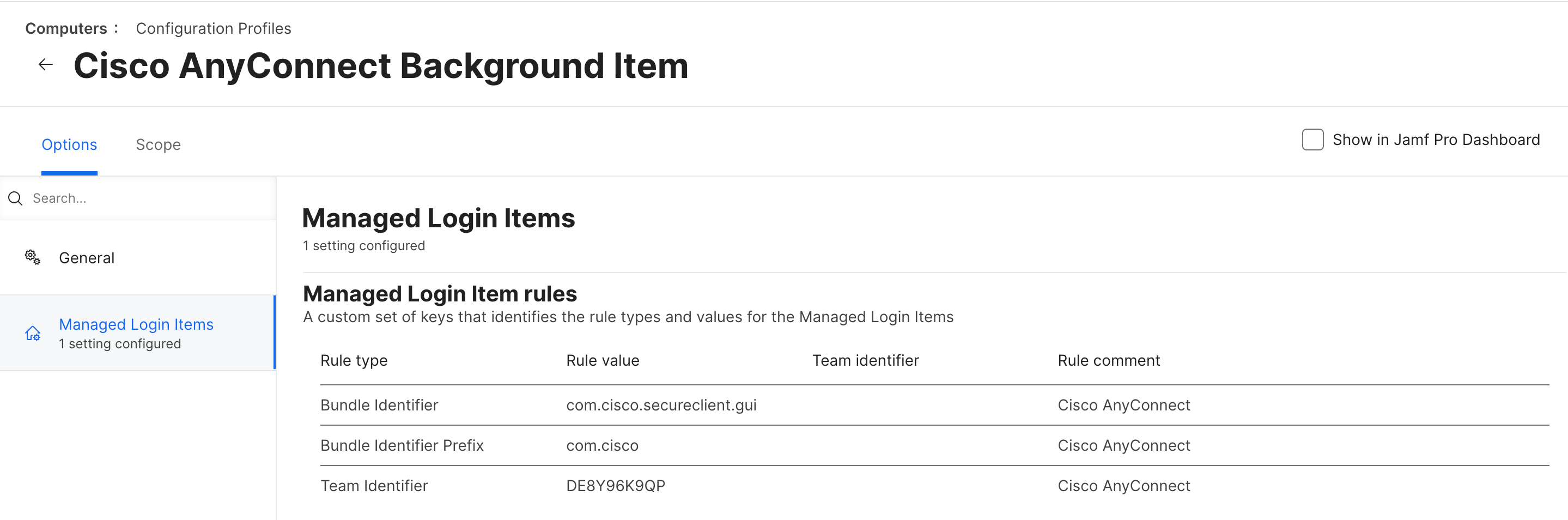

Got it working with the following config:
I have this working on 2 test Macs and on my production Mac, using the above config profile that @hhorn posted. However for 2 of my test users that I've deployed the same config profile to and the same version of AnyConnect (5.1.1.42), but they are still getting "no connection... Reattach failed"
What could be going wrong on my test users?

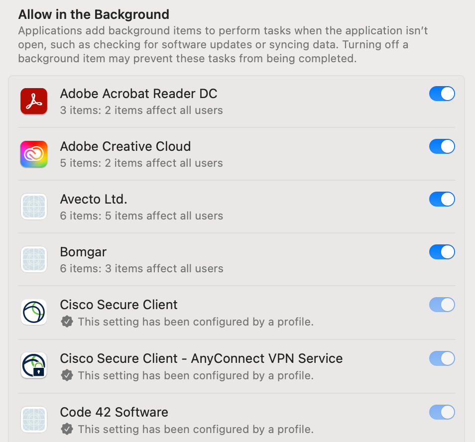

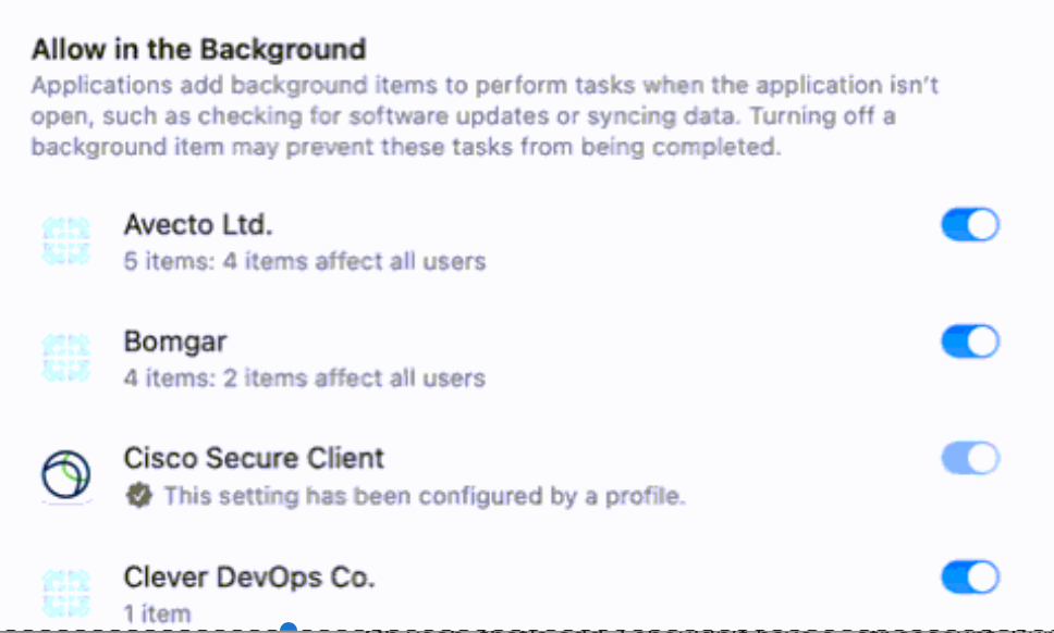

I found the problem is that the login item for "Cisco Secure Client – AnyConnnect VPN Service" isn't showing up on the devices that are having trouble.
On my device where it is working, I do have the item:
How can I get "Cisco Secure Client – AnyConnnect VPN Service" to show up here?
Just curious if there was a reason to do both "com.cisco" and "com.cisco.secureclient.gui"?
