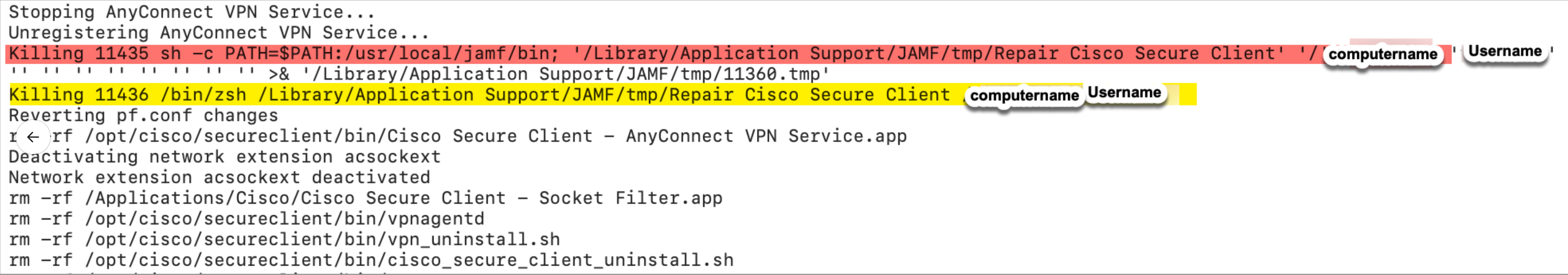

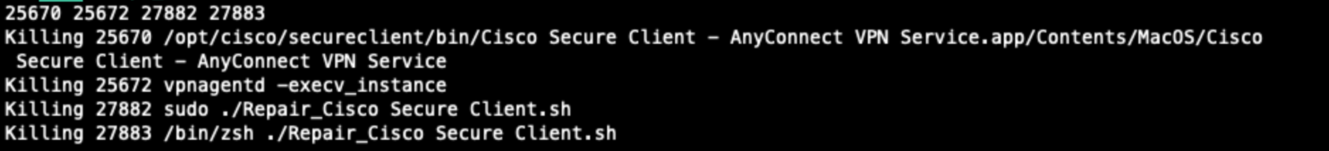

I had the same issue with a policy which contains a script to first uninstall Cisco Secure Client and then install the new version of Cisco Secure Client triggered by a separate policy.
The uninstall part which also uses the vpn_uninstall.sh in /opt/cisco/secureclient/bin caused the issue. As in this script, every process is killed which contains the name "Cisco Secure Client". And our Script was named "Install/Update or Repair Cisco Secure Client". As this script contained "Cisco Secure Client" in its name, vpn_uninstall.sh script of Cisco has been killing my script which was triggered by our policy in Self Service.
After renaming the script in Jamf, the Problem was solved.

  • December 6, 2023
Hi
Dont know if this is also the issue in your case but is worth a shot to take a look at.

Renamed the package from "Cisco Secure Client" to just "Cisco Secure" and it worked no issues.  I am so annoyed it was something like this, but as long as it's working now I'm ok with it.

In my case, my package was name included "Cisco Secure Client", so when the install ran, the initial uninstall step from Cisco's pkg force killed my pkg I wrapped it in.  When I built it exactly the same but named "Cisco Secure" instead of "Cisco Secure Client", everything worked fine.
