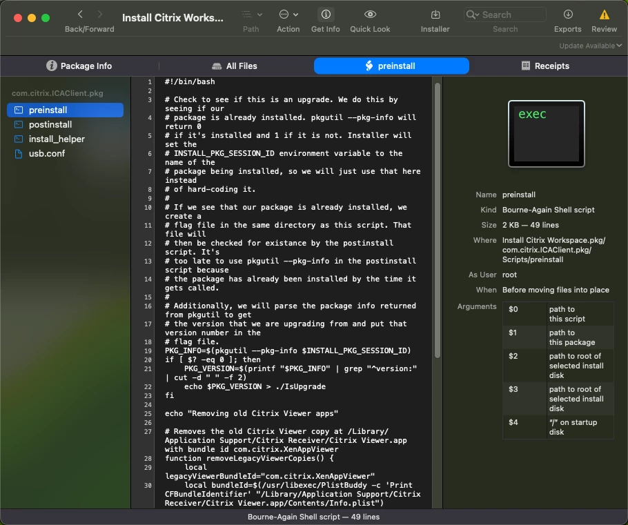

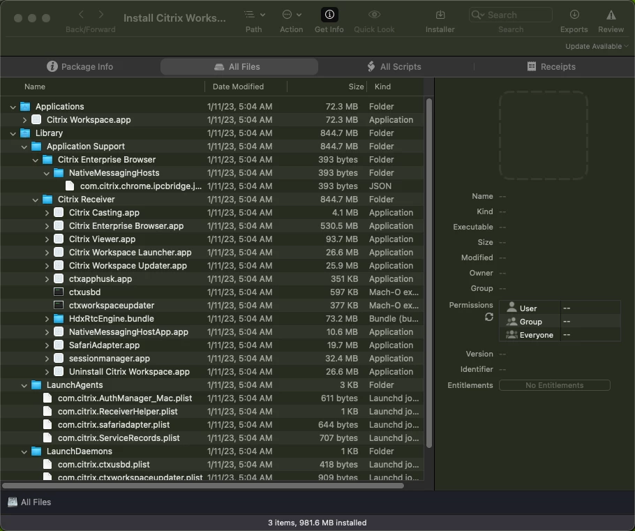

Citrix provides workspace as a .pkg that is fully deployable. Dont repackage it, just use the package Citrix gives you and be done with it.
For Citrix their package is more or less an installer, unless you are reviewing file per file to see what is needed vs not needed odds are you are missing something the app needs to function. There are also four scripts in the package that you would need to parse to see what is needed vs not needed before you attempt to repackage from source.
