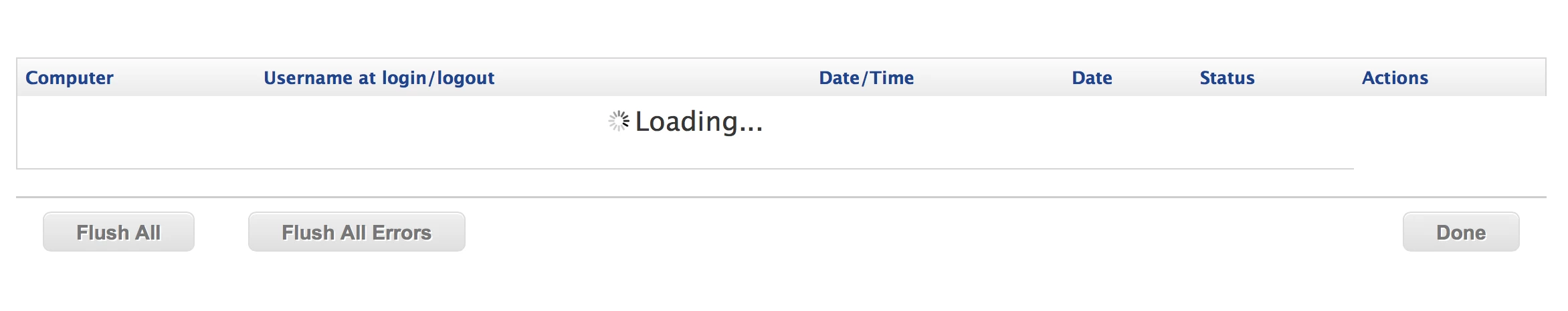

is there a way to clear a specific policy's log w/o actually going into the policy and clicking logs? I know there's log flushing in settings, but i don't necessarily want to flush all of them... And there's so many logs in this one policy it's taking too long to load them (been waiting nearly 30min so far).

The delay (still going btw) is when I go to the policy, and click on logs. That initial list is what's delaying causing my safari to be running @ about 13% constantly. I'll try cloning the policy and then deleting the old one, still a bit of a pita to do ongoing but it's a start.

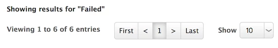

scottb
  • May 27, 2015
@jwojda
If I get what you're saying, change the setting at the top of the page to a small number - I use "10" like the pic below. That way, it's not trying to load a bunch of things on the page at once. If it's something else, apologies...

not exactly, this is when I just click on logs itself from within the policy.
scottb
  • May 27, 2015
But what do you have for "Show"? All? 100? 500? 1000?

it's not getting that far. that was the whole thing (save for the policy title). but they are probably set to all... ah. i gotcha. I went into a failed only policy display, changed to 10, and now it displays on the ones that were hanging! :)
thanks!
