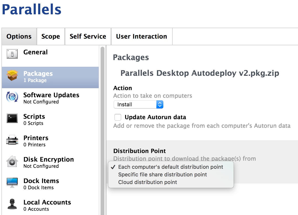

@powellbc If you are doing cloud based Jamf administration you can in a way do what you want in regards to you question #3. What you can do is allocate where the policies install the applications from. If you are manually syncing content from distro to distro you can choose your content that resides on them and keep your main DP filled with the larger files. In the latest release you can classify your DP's and where the policies get them. You will always have a "Master" and replicas, its just the way its designed. The screen shot shows you where the options are.

@Npotter229 A valid option, however I believe this would introduce significant administrative overhead as you would need to select "Cloud distribution point" for all of what I assume would be the more numerous small packages.
Remember that those options are for all computers running the policy.
