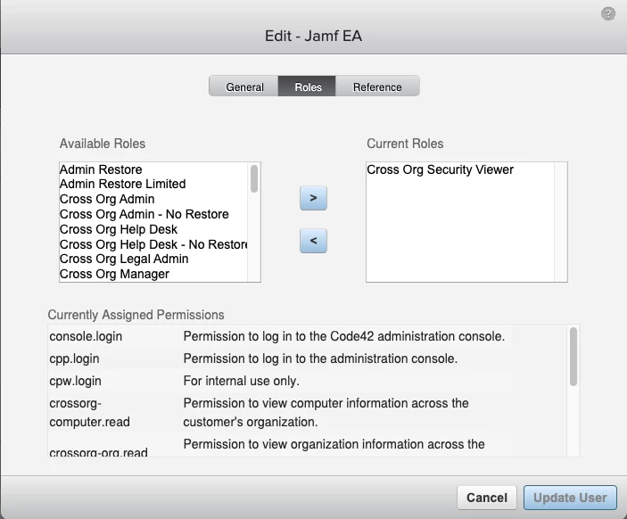

Working on revamping all the EAs for Code42 CrashPlan to be compatible in 2020 version 8.2+
@jamf is there a way we can get the CrashPlan (now Code42) Templates all updated with these revised EAs?
I will be updating this post in the next 24-48 hours as I get them worked through the rest of the way. If anyone has ideas on how to simplify the code down short, I'm all ears :) I prefer to do Python looking at the JSON returned values to get the correct Key-value vs. grep/awk/sed (bs) as it makes the code more easily read and it ensures that even if the location of the keypair gets moved, we're still okay.
Remember to keep your Code42 account limited to the lowest Roles possible to do its required job, which in this case is Cross Org Security Viewer:

#Configure an API account with the minimum roles possible, for cloud customers, this would be Cross Org Security Viewer and must be a LOCAL account within the console, this will allow READ access ONLY. If you are a cloud customer, this is also required to be a full email address.
CP_AdminUsername="yourAPIacct@yourorg.com"
#Configure to your API account PW. If desired, you could encrypt this with base 64 or a keypair stored in a separate file or config profile elsewhere on the machine to avoid having it in plaintext. Since you should have limited the rights of this account, the vulnerability will be reduced.
CP_AdminPassword=""
