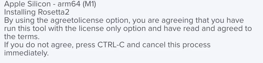

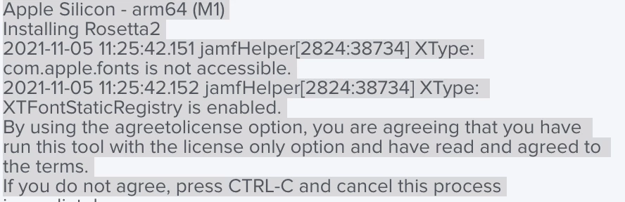

Started noticing this on machines for my enrollment script using jamfhelper.
Doesnt seem to have any real bearing on outcome as the text prompts still show up, but in the logs, most, if not all, jamfhelper prompts are followed by com.apple.fonts not accessible.
Excerpt from log with macOS Monterey with M1 pro
Log from M1 with macOS Big Sur
Any ideas why this is a thing?

2392022-02-14 08:01:29.272 softwareupdate[6024:19909] XType: com.apple.fonts is not accessible.
2022-02-14 08:01:29.272 softwareupdate[6024:19909] XType: XTFontStaticRegistry is enabled.
