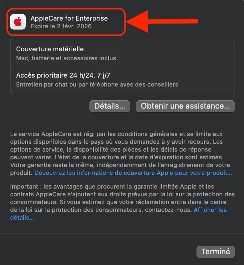

Testing this prior to coding an EA. Ive noticed that on 'some' devices, the folder /com.apple.NewDeviceOutreach does not exist.. and of course then nor the plist.. when looking at system settings I see this dialog.. pretty sure no one has invoked this..  so do we know how this is created?
@YanW Do you know how (and when) the folder /com.apple.NewDeviceOutreach is created ? I have the same issue, some computers don't have it. (and I don't know why... :-) ).

I suspect the existence of the folder might only be available to the account first setup with the device. I am waiting to come across a device I can potentially identify this to be true.

I believe the warranty.plist is created for any user who checks the warranty of the system from the system.  They would browse to the warranty lookup Apple Portal and provide the systems serial number https://checkcoverage.apple.com/ whatever user is logged in will then have the warranty.plist written in the context of their login

I have 510 reports of AC+ information now of 1400+ devices
I believe the reporting factor is actually who has an iCloud account signed in and who doesn't as I have checked coverage on a device that has no iCloud signed in and it would not report the information required. It's plausible that AC+ might have to be current for it to come through though.

seems I also had to go to Apple > about this Mac > support tab for it to populate, but I am fairly confident that many of the examples I have would never had done that step, so quite possibly it could have generated this step on its own at some over stage.
I am keeping an eye out for devices from this point to see if they have iCloud signed in, as to confirm the main contributing factor.
