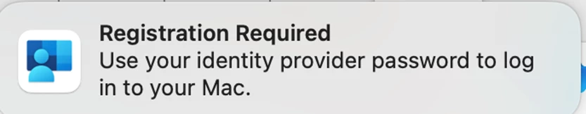

Microsoft has released Company Portal 5.2401.2 with support for Platform SSO.
Users with SSO profiles receive a pop-up requesting registration with Azure Account to synchronize the local Mac password.
Has anyone had this experience?

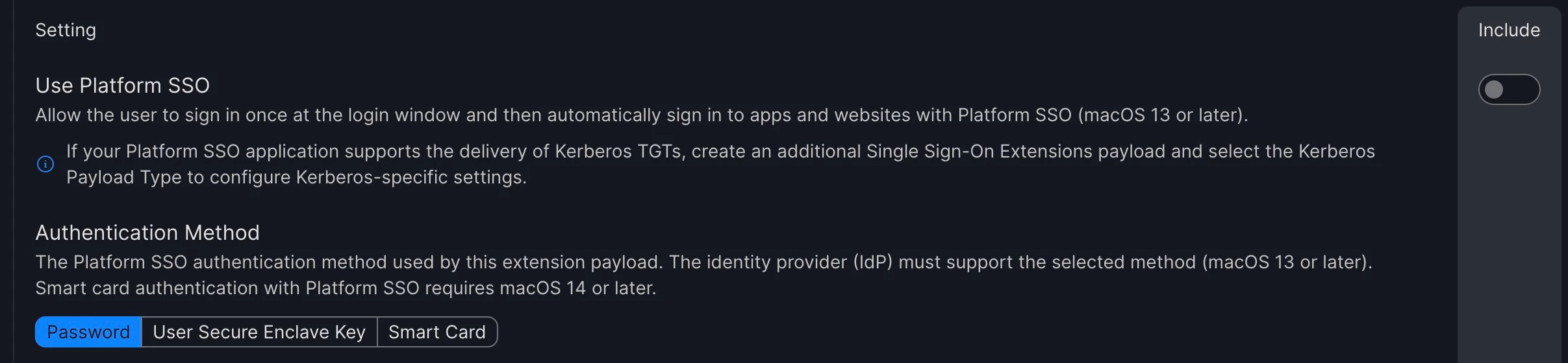

Please review your SSOe configuration profile within Jamf Pro and disable the Platform SSO support. That should prevent the pop up for users. May require a system reboot after you deploy the updated profile to your fleet.
I disabled the Platform SSO setting in our Microsoft Enterprise SSO profile and this seems to have fixed the issue. When you read what the setting does, it is only related to the sign-in window.

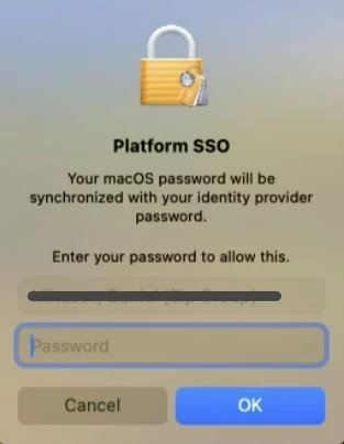

The behavior is not the best.
If you have Company Portal 5.24 and PSSO enabled, the macOS starts the registration notification.
If the user does not register, removing the PSSO stops the notification. So far, it is consistent:
PSSO ON = notification enabled
PSSO OFF = notification disabled
Problems start when the user completes registration:
1st problem: a new device is registered in Entra ID with a different ID and compliant is N/A - then fails Conditional Access.
2nd problem: "password change" is disabled on macOS, so it is necessary to change the password from Entra ID. Here I need further testing, but in the first facts the local user password is not changed and I fear for FileVault.
All these settings seem to introduce interesting new features, but there is a lack of documentation and tests and we are going by trial and error at this time.
Updating the documentation is very urgent

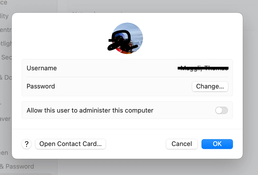

  • March 21, 2024

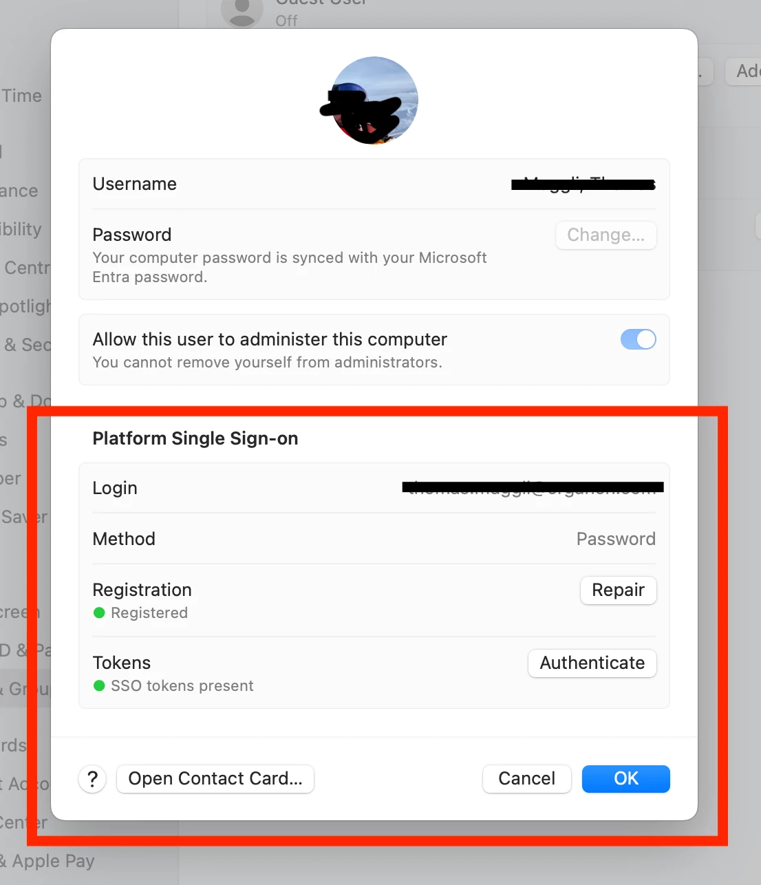

Microsoft really screwed alot of us with this and has been zero help so far. But that isn't a surprise. Anyway....
Here is what we have found. Anyone that incorrectly clicked to do the PSSO is probably never going to get fully straightened out just by redoing the Intune Integration registration from Self Service. If a user didn't click it and you disabled the “use Platform SSO” setting in your profile then they are probably good to go. Anyone that had already accidentally enabled it, it will stay enable no matter what the profile says. Reboots don't help.
What I found is that anyone who clicked and technically enabled PSSO there is appears that there is no way to get rid of it....but there is.
If you look at the user's System Settings>Users & Groups> {user's account} and click the i....
This is bad, it means the PSSO is enabled and Enterprise SSO is going to continue to have issues. If they show the Platform single Sign On section in their account then it is already enabled and messing with SSO.
This is good, it means that the user didn't click and didn't enable PSSO. These users probably aren't having issues or just need to register again from Self Service.
The only way I have found to get rid of the "bad" is to exclude the user's computer or some smart group from the SSO profile so it is removed from their Mac. This will disable the SSO extension and get rid of the PSSO. Wait a few minutes, then remove the exclusion so the SSO profile is installed on their Mac again which will reenable the SSO extension including not enabling PSSO since you probably/hopefully already disabled the setting. After getting the profile back on the Mac, confirm the PSSO section is removed from their account info. After this the user should be able to register again via the Self Service policy, wait a few minutes for Entra/Intune to catch up, then they should be able to sign in again, use SSO and all of their problems should be solved. No restart was need in my experience.
Hope this makes sense and helps those pulling their hair out with the mess.

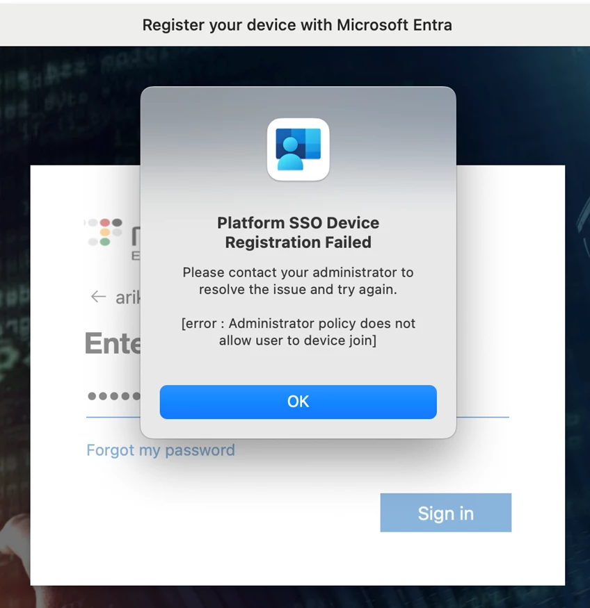

We have a different issue but very similar, we got the error attached after the 5.2401.2 update.
Think that a downgrade will work for me, but I can't find any PKGG files.

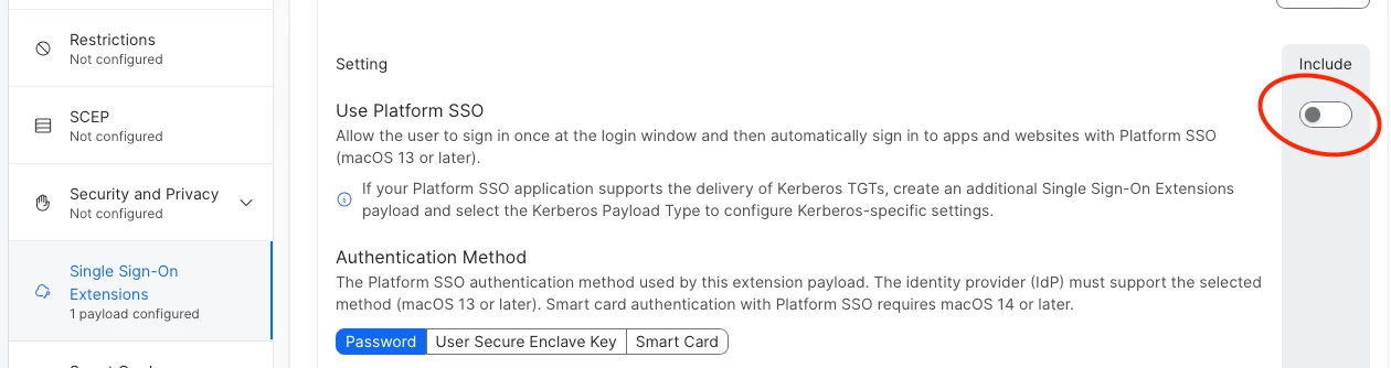

Instead of excluding it I updated the config profile to disable Use Platform SSO, that removed the settings on those Mac that had registered using the pop-up.
but I do hear compliant about Microsoft apps not working for those who registered.

I can confirm the behavior.
The only way to disable PSSO is to remove the SSOe profile completely. Disabling PSSO in the SSOe profile is not enough.
Once removed, you can deploy SSOe without PSSO

To remove the notification, it is necessary to remove the SSOe profile completely, then deploy it again without PSSO.
it is not sufficient to remove only PSSO
