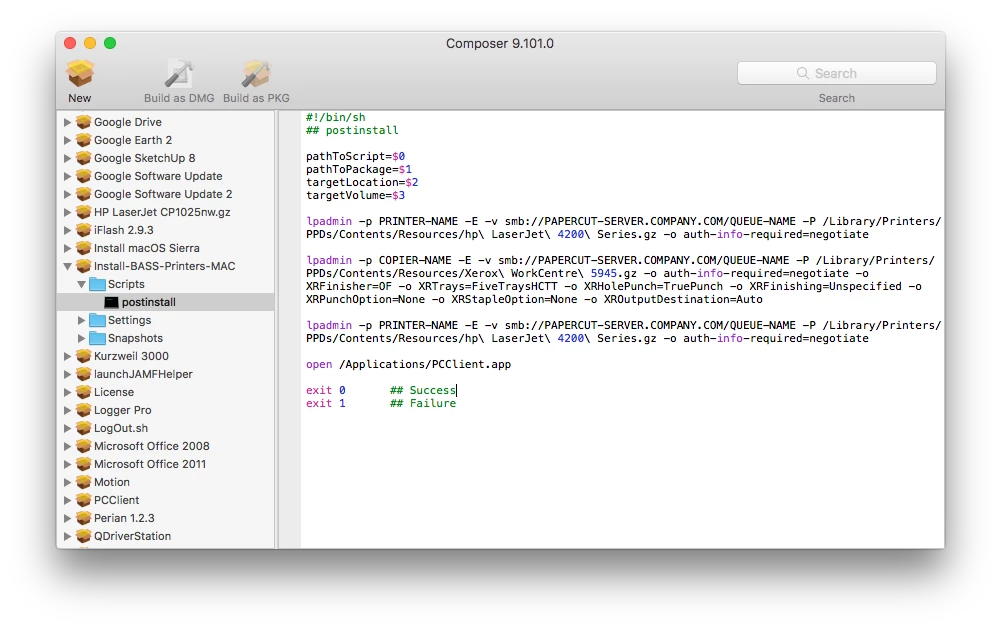

@Thai No problem: I do just want to clarify that I do this two different ways. One for jamf Managed devices and one that can be installed on any un-managed macOS system. First, what you see above are all great ways to handle print queue installations via jamfPRO. In my case, I have a custom installer for PaperCut and separate policies for installing print queues. PPDs and other print drivers are installed during imaging/onboarding and updated via automatic policies when I update them. That aside, here's how I deal with unmanaged macOS devices
Un-Managed Papercut Client and/or Print Queue deployment:
First, I want to install PaperCut. This is completely independent of any print queue I may want to install. This part is also unnecessary for anyone not using papercut (Or using papercut with un-authenticated queues). This is completely unnecessary is you do not use PaperCut. Feel free to use the rest of the instructions though.

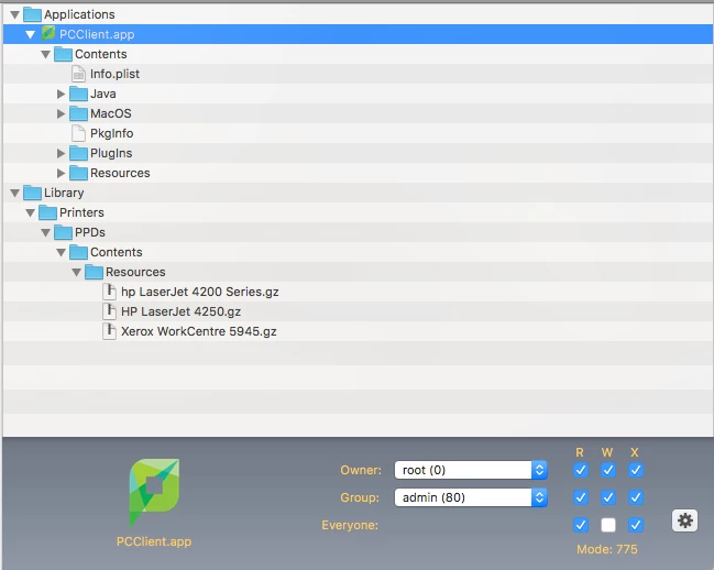

•) Drag your custom PaperCut Client into Composer (I'm assuming that you would have followed CrashPlan/jamf's knowledge base article on just how to do so.) ** Since these are unmanaged systems I do not install our launchagent. These users will leave after a month or two and I won't have a chance to uninstall it for them.

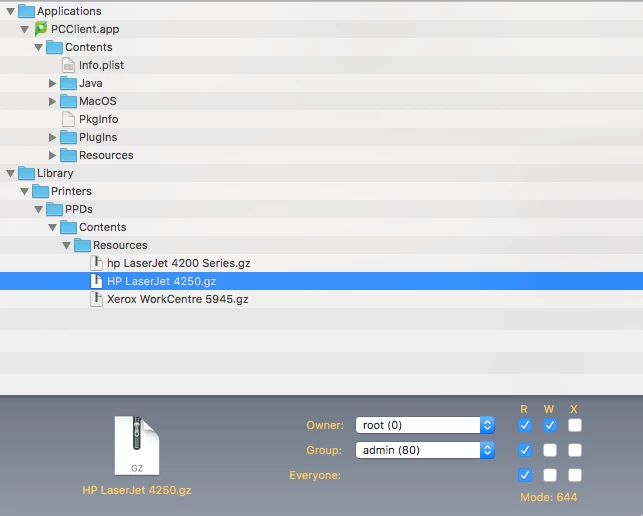

•) Drag any and all required PPDs into the same composer window. In my case I needed to cover HP4200 and HP4250 printers, as well as Xerox 5945 Copiers) - You can also place any driver installer package in here to be installed by the "PostInstall Script". I tend to use "/private/tmp" or "/Users/shared/" for this.
•) Adjust permissions as necessary (PCClient should have the following permisisons)
The PPD files should have the following permissions (Wheel would also work for 'group)
Now we need to put together the script to get this all up and running. The big difference is that we're not using jamf policies to manage the individual "pieces" of this as this package needs to setup everything our users need to print. This script is going to be written or copied into "postinstall", under scripts in Composer. The other PPDs are loaded into the directories shown in the Composer Screenshot.
** If you want to install a manufacturers driver .pkg (or any other .pkg for that matter) you can load that into Composer. I recommend using /private/tmp or /Users/Shared. Remember to use sudo to isntall as the final package will be isntalled by a users account, and not jamf's root access.
example install command for a HP driver package, loaded into /Users/Shared
sudo installer -verboseR -pkg "/Users/Shared/HewlettPackardPrinterDrivers v3.1.pkg" -target /
Remember to use sudo as this will be running directly from the user account, NOT via root as a jamf policy normally would.
• It's important to remember to get all your drivers in place before setting up print queues.
• With that done you want to go ahead and install the actual print queues. I use lpadmin. I intend to set up three printers here. Each will get its own command.
Note: At the end of the script I simply open the PCCLient application to get it in the users face... otherwise, they won't really 'see' anything happen.
With all that written, you can then choose "Build as .pkg" at the top of the composer window and that's it. You'll have a .pkg that will install your print drivers, print queues and any other print management item you may need non-managed users to have.
Does this help?

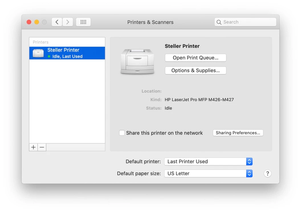

I've read several posts of techs using Jamf Admin to capture the already-installed printer and then "packaging" the driver to run on the same policy. I can do the first part but get lost on how to "package" the driver using Composer. I used Composer and removed everything except the appropriate .ppd file (HP LaserJet Pro MFP M426-M427.ppd) before creating the pkg file. I then put both printer and printer driver in same policy to push out. However, when I go over to my test machine I see a generic printer installed and the driver is no where to be seen. What did I do wrong?
I feel like I need a script to install the driver in it's proper place (ex. /Library/Printers/PPDs/Contents/Resources/HP LaserJet Pro MFP M426-M427.ppd) but not sure.
