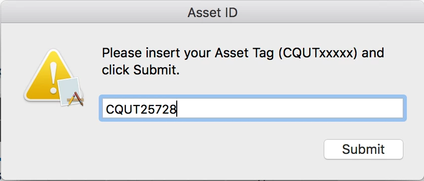

We modified a pretty neat one that has likely been listed above. It pops up and asks the client to enter their Asset Tag number then renames the Mac locally and in the JSS. A policy runs this after pre-stage enrollment (we're aiming for zero touch).
I had to put a 30 second delay on it. If it runs while the client is in the "Security & Privacy" acceptance screen, the Asset Tag popup hangs and you can't enter any information in to it (pressing 'submit' works but you can't edit the field). This works on the presumption that the client won't start setting it up, then leave it on the Security & Privacy screen for longer than half a minute.
Simple and effective!
#!/bin/sh sleep 35 computerName=$(osascript -e 'tell application "SystemUIServer" set myComputerName to text returned of (display dialog "Please insert your Asset Tag (CQUTxxxxx) and click Submit." default answer "" with title "Asset ID" buttons {"Submit"} with icon caution) end tell') /usr/sbin/scutil --set ComputerName "${computerName}" /usr/sbin/scutil --set LocalHostName "${computerName}" /usr/sbin/scutil --set HostName "${computerName}" dscacheutil -flushcache echo "Computer name has been set..." echo "<result>scutil --get ComputerName</result>" exit 0
