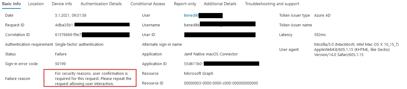

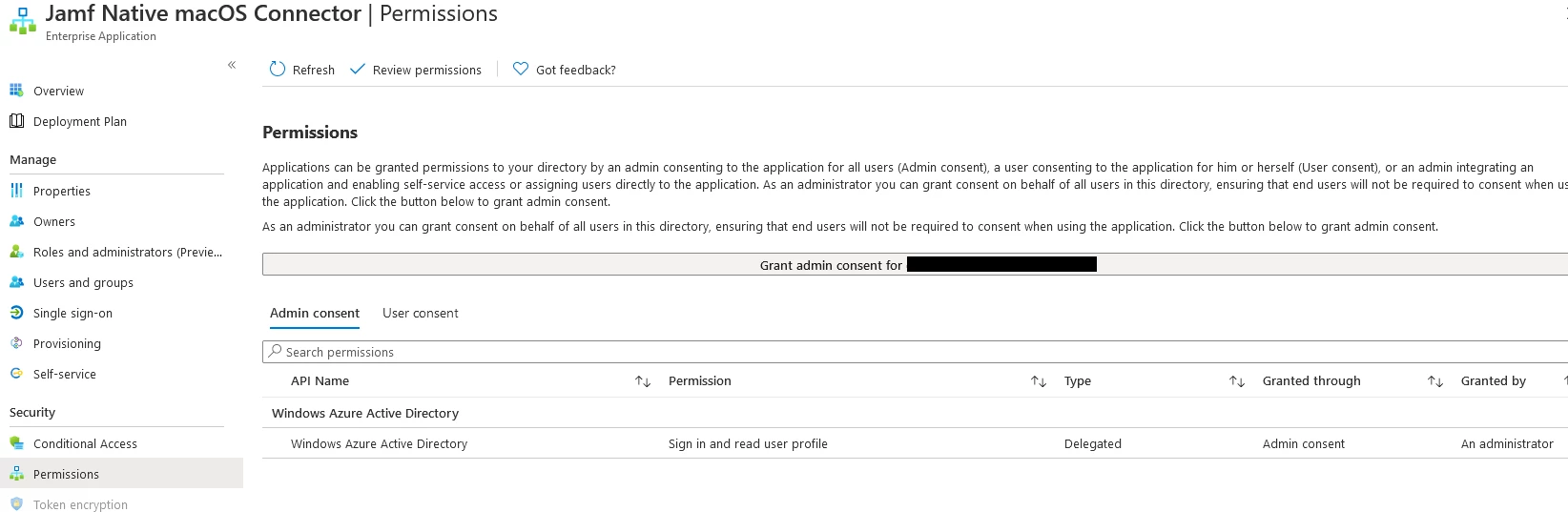

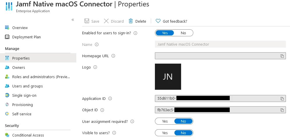

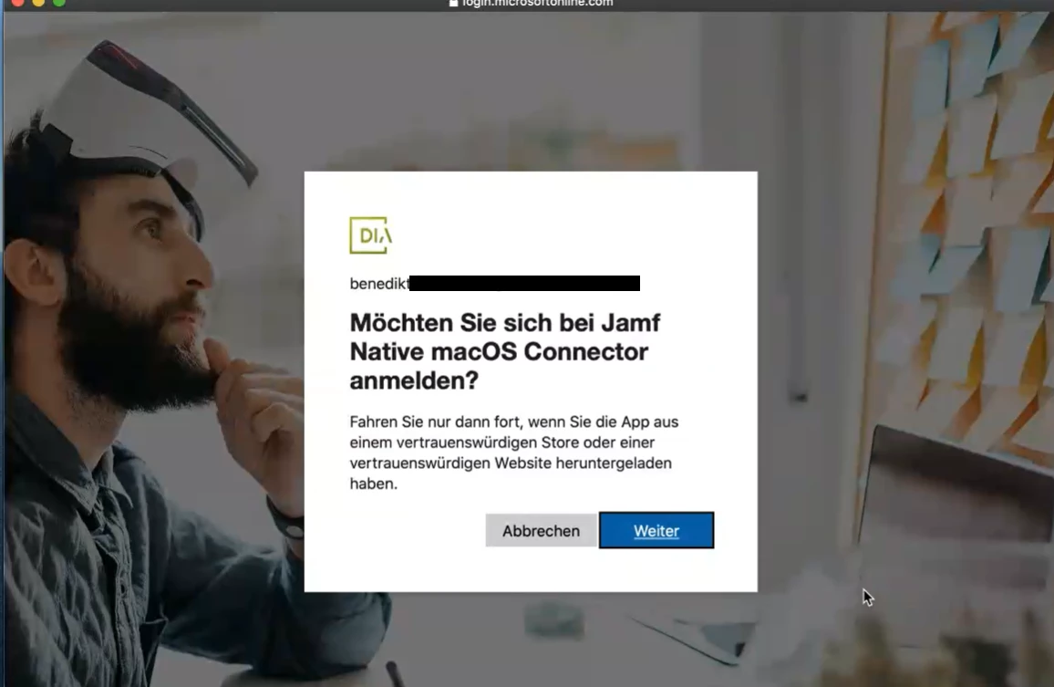

Hi, We've setup the Intune Registration at Jamf properly. Devices are successfully imported to Intune. But there is an additional window at the registration process, which asks the user to allow the "Jamf Native macOS Connector". Accroding to the Jamf documentation, this window shouldn't appear? I already checked the permissions at the app which seems fine to me. We haven't assigned any endusers to the app, but enabled for signin. Do I miss something?
Regards,
Jonny
Update: After some further investigation, I've found this error message, but I have no idea why this is happening. Will open a case with Microsoft Support.

I checked in our setup. There is only the setting "visble to user" set to yes. You checked already the setting on the JSS as well? Do you checked-in your clients via the CompanyPortal in the SelfService?
Best
Thorsten
jonn1e
  • Jan 15, 2021 1:06 PM UTC
@Cyberghost Thanks for your reply. The setting "visible to users" defines if the user can see this app at his App Dashboard at AAD. But I guess that is not the root cause of the issue. I've got two policies, one for the installation of the company portal and another for "Register for Device Compliance with Azure AD" which are pushed to the users. If they accept popup for the Jamf Native Connector it's fine and the devices are succesfully registered with Intune.
But actual the user have to enter his credentials 3x times for registration and I try to simplify the process regarding the jamf documentation where the popup isn't documented.

Sorry, didn't count the access to keychain. So it's 4 times with the keychain in our environment. As you mentioned, the first time is for the Company Portal, the second for the registration and the simultaneously with the keychain request a third popup which is asking also for credentials and consent for MacOS Native Connector. So It's one step more which is also not documented. Something is wrong.

I already searched our AAD for any settings that may be the root cause of the user consent question, but normally the app shouldn't ask if a global administrator already granted all needed permissions. Did you noticed the error message in third screenshot? Would it be helpful to delete the Native Connector App and reinstall it or will this may broke something in the background?
Correct; if a global admin has granted the consent experience that should not be the case, and I know for people that see that it was not always (since the inception of the connection) it seems to have only been in the last quarter or so (no hard date as different people noticed it at different times).
Yes; that is where I think we should grab a sysdiagnose from an affected Mac and break down the MSAL traffic that is taking place since maybe it is down to how MSAL (inside of jamfAAD) is doing the request.
Possibly; but only if you had not used a Global Admin account prior, and it sounds like you had.

We discussed this issue over weeks with the support and the result was that all popup windows are intended. They didn't fix the documentation with correct screenshots, which is quite confusing. Beside that, the "registration flow" isn't that reliable for a proper documentation. Sometimes windows vanishes or simple doesn't appear when the user try to register it's device. Especially the last window throws often an error message and left the user clueless. I'm not sure why this is happening or what is the root cause. BUT if the device is registered successfully, it runs without any issues (for the moment) and Conditional Access can be enforced.
So the registration process looks like the following for our AAD:
  1. First Login on MacOS at Company Portal, triggered by Self Service Registration Button
  2. Second Login also at the Company Portal in a separate Window with MFA -> Company Portal completed!
  3. After a few seconds the little window from Jamf with the help text, triggers a third default browser popup which is asking for consent to Jamf User registration. We noticed that it must be Safari to accept this. After that Jamf is asking for the users MacOS keychain password. --> Finished
You must ensure that the User have an AAD P1 and Endpoint Manager (Intune) License. Second bump could be conditional access rules which must exclude the registration Apps from Jamf. Last but not least, we setup the whole Jamf <-> Intune configuration once again with the automatic setup.
