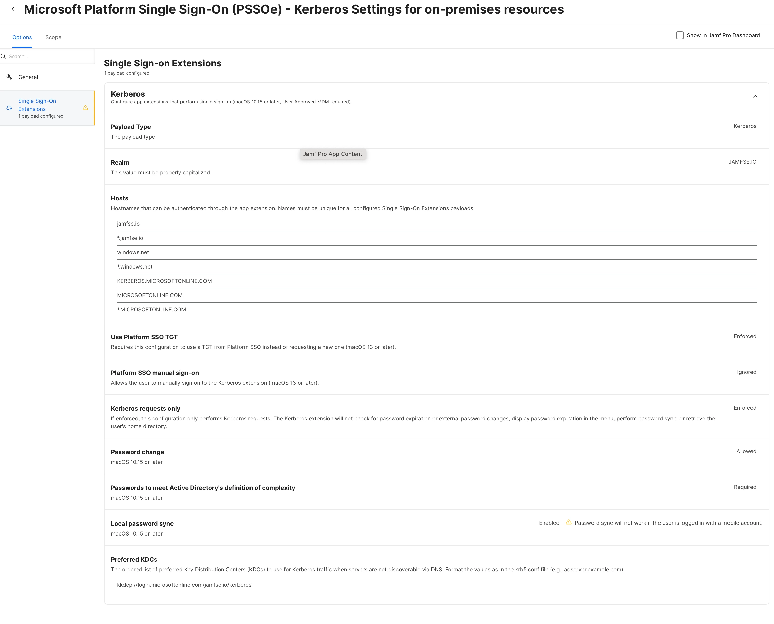

  • Payload Type: Kerberos
  • Realm: The name of your Kerberos realm which must be properly capitalized (e.g. EXAMPLE.COM)
  • Hosts:  Add all of the following hosts.  Substitute example.com with the fully qualified Kerberos realm for your directory.  Follow all capitalization exactly.
    • Your Kerberos realm (e.g.
      example.com
    • Your Kerberos realm with the preface of . (e.g.
      *.example.com
    • windows.net
    • *.windows.net
    • KERBEROS.MICROSOFTONLINE.COM
    • MICROSOFTONLINE.COM
    • *.MICROSOFTONLINE.COM
  • Use Platform SSO TGT: Enforce
  • Platform SSO manual sign-on: Allow
    • This setting permits users to manually enter an on-premises user name to obtain tickets should a UPN user name used by Entra not match the desired user name on-premises.
  • Kerberos requests only: Enforce
  • Password change: Allow
  • Passwords to meet Active Directory’s definition of complexity: Require
  • Local password sync: Enable
  • Preferred KDCs: Modify the following to substitute example.com with your fully qualified Kerberos domain name
    • kkdcp://login.microsoftonline.com/example.com/kerberos
Set Scope to devices that also have the Platform Single Sign-On profile deployed.

Example screen shot of payload:

I'm afraid this one I don't have an answer for.  AppleCare / Microsoft support case will need to tell you the answer to what that key specifically means.  I know that in my sampleI did NOT have cloud kerberos tickets enabled in Entra yet which is why you see a kerb ticket with the realm of
and not the expected realm of JAMFSE.IO.  Once we turned on the cloud kerberos feature of Entra, we're getting two tickets as expected.  Microsoft has updated their documentation as well to say that you should turn on the cloud kerb feature.

Hi, if you have cloud kerberos enabled, can you set your REALM to KERBEROS.MICROSOFTONLINE.COM?
Or is it better to use the on-prem AD realm?

I followed these steps and it appears to be working on my test Mac. I can go to internal company sites and I am automatically logged in. I can see a Kerberos ticket in Ticket Viewer, and when I run "klist" in Terminal, I can see the Kerberos ticket. When I run app-sso platform -s I see a null value. I checked my settings in my profile. They are the same as what was described and shown here. Another thing I noticed is that after a reboot or log off and login, my account is not being signed in. What could be causing these issues?
Your screen shot shows that the PSSO credentials are completely missing and the device is not registered.
You could, I guess?  But most likely you want to enable the cloud kerberos connection with microsoft to get a real on-prem ticket which is what all of your on-prem resources like file shares would use.

Hi rabbitt, we've been engaged with Apple support for a while now without any luck, we have 2 profiles configured for PSSO and kerberos SSO, we do get proper tickets at start-up but after a random amount of time the tickets no longer work and are not refreshed. We went through our config a dozen time, and engaged our network team to eliminate network related issues but we are still encountering the issue. Also when we enable the refresh option for user, manual refresh causes a kerberos extension crash
Isn't it what we are doing when we are configuring the Kerberos SSO profile in Jamf using the realm
Did you ever find the answer to this issue? We are currently in the process of rolling out PSSO + Cloud Kerberos. What I have found is if you switch networks you lose the TGT when running klist in terminal. I am also a little confused with the MS documentation: https://learn.microsoft.com/en-us/entra/identity/devices/device-join-macos-platform-single-sign-on-kerberos-configuration
If using Cloud Kerberos you don't need to specify any on-prem domains?
