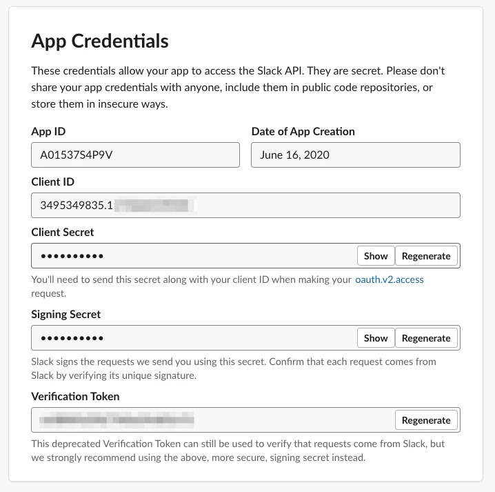

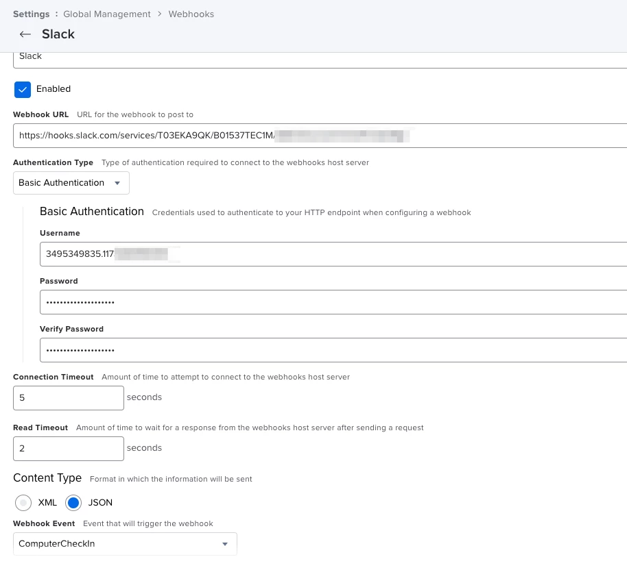

Hi everyone,
I'm trying to use the Webhook feature from JSS to send incoming alerts to Slack.
So I created a webhook adding all information coming from the Slack App I created for the purpose
Everything looks correct for me but I cannot make it work. Does anyone have Slack integration working?

@PayFit
I set this up in January of last year using AWS Lambda to relay the webhook. The Jamf webhook will not relay to Slack without an intermediary step, hence the need for Lambda. I wrote up the process, including the node.js that was needed to make it work.
Using AWS Lambda to Relay Jamf Pro Webhooks to Slack
Between that time and now there were some changes to the Node.js version that AWS supports and I had to make some edits to get it working. Unfortunately I removed all of the Slack pieces and instead moved over to feeding these to our MS Teams environment instead. I should write that up someday...

We have a guide that may help you with this. https://hcsonline.com/support/white-papers/how-to-send-jamf-alerts-to-slack
