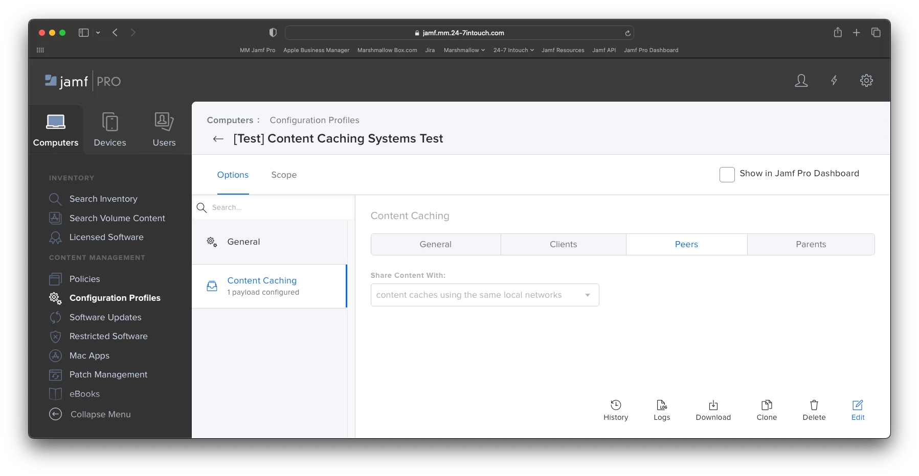

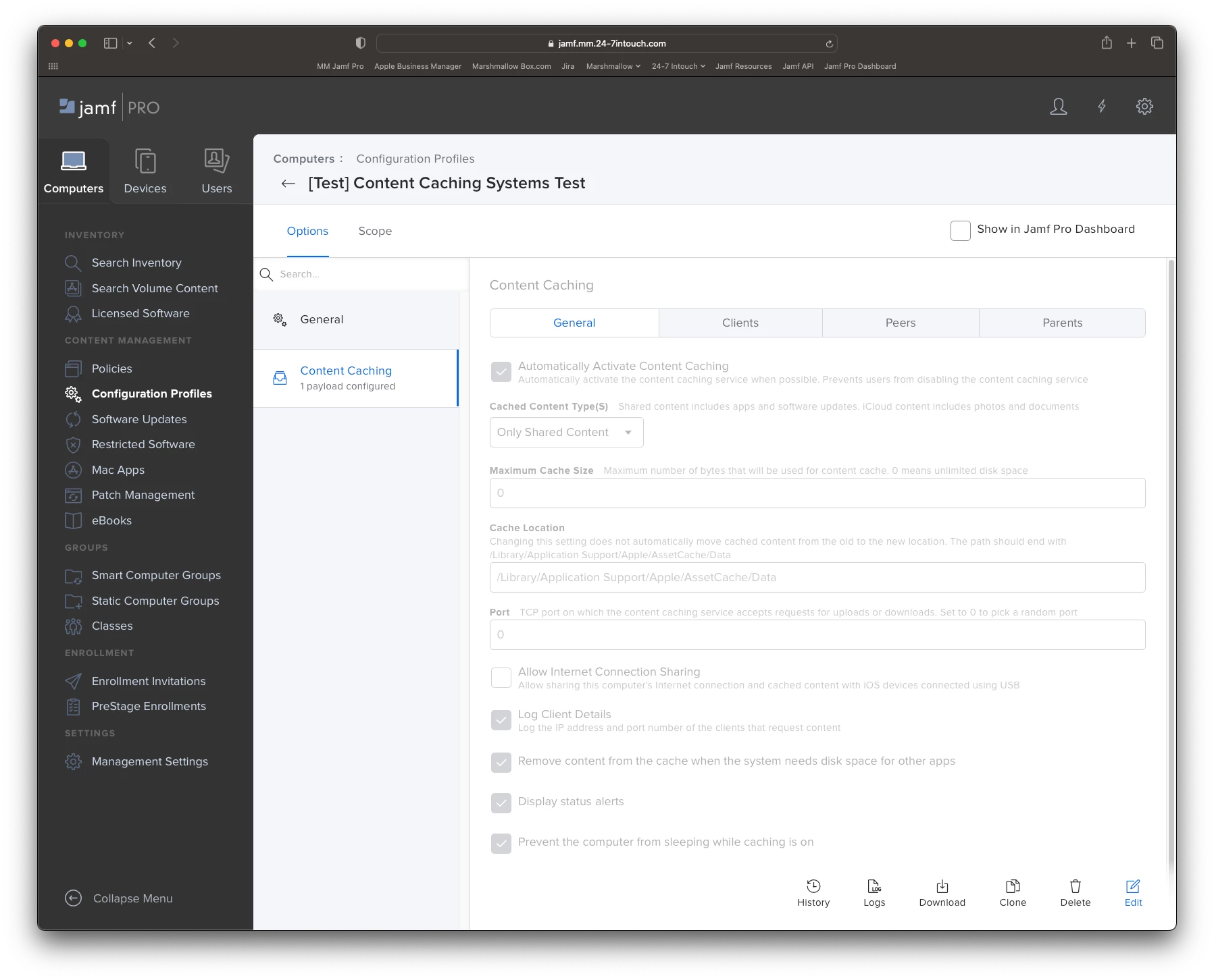

I've created a Configuration Profile for the Cache System and the end-points with the following
Configuration Profile Settings.
I have read https://support.apple.com/en-ca/guide/deployment/depde72e125f/web and https://support.apple.com/en-ca/guide/mac-help/mchl3b6c3720/mac and I can't seem to get it working
Do I need a DNS TXT record? I didn't put one in since I set the My Local Networks to use one public IP address
What am I doing wrong?
Here is my Configurations settings

I think your problem is that you're trying to do this via MDM. Just enable content caching on the content cache server with the default options (both server and clients share the same IP address if I understand what you wrote above correctly) directly from macOS without the use of JAMF. Clients don't need any configuration at all, they will discover the cache automatically. If it still doesn't work, check status of the cache (perhaps your server has a different external IP than the clients?), and check the logs. AssetCache has a pretty extensive logging capability that is pretty clear if something is broken.
You can also verify manually from a macOS client that your cache is indeed working from the client by using the utility AssetCacheLocatorUtil.
