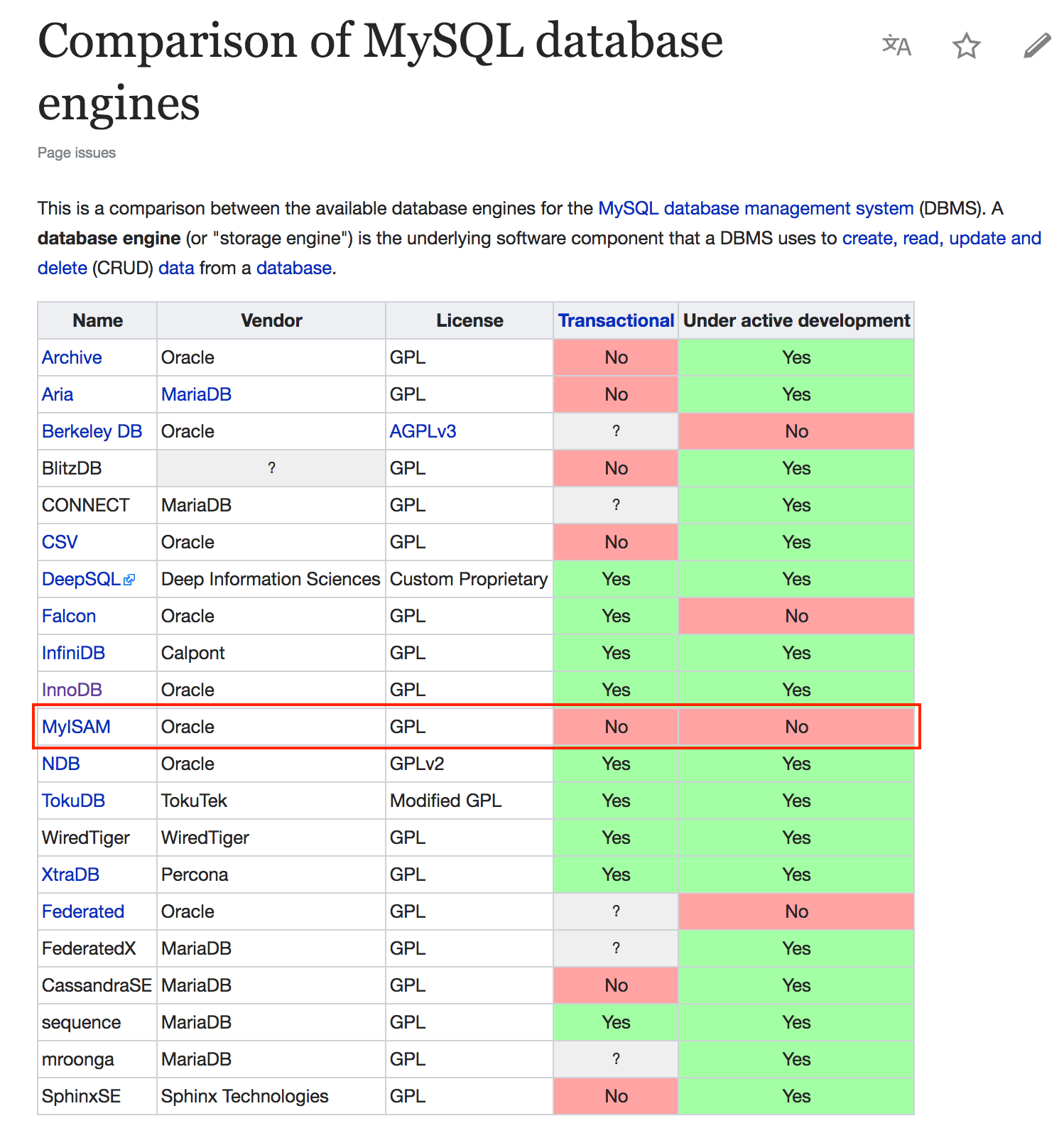

InnoDB (Wikipedia)

On a call today we were, um, well, alerted to the fact that MyISAM is no longer actively developed...
