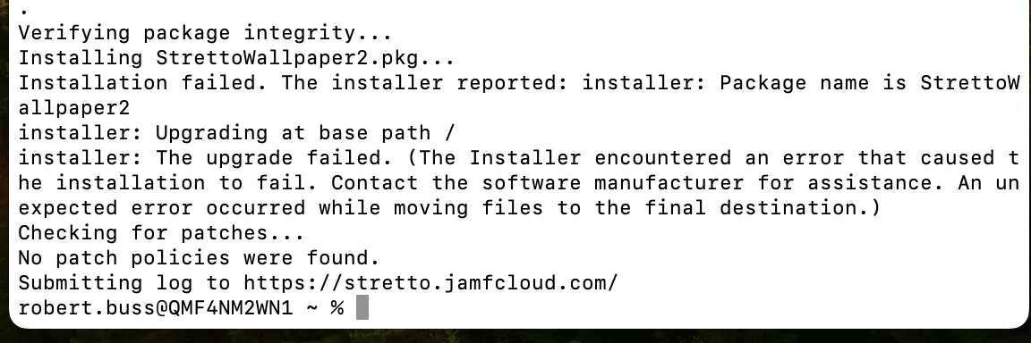

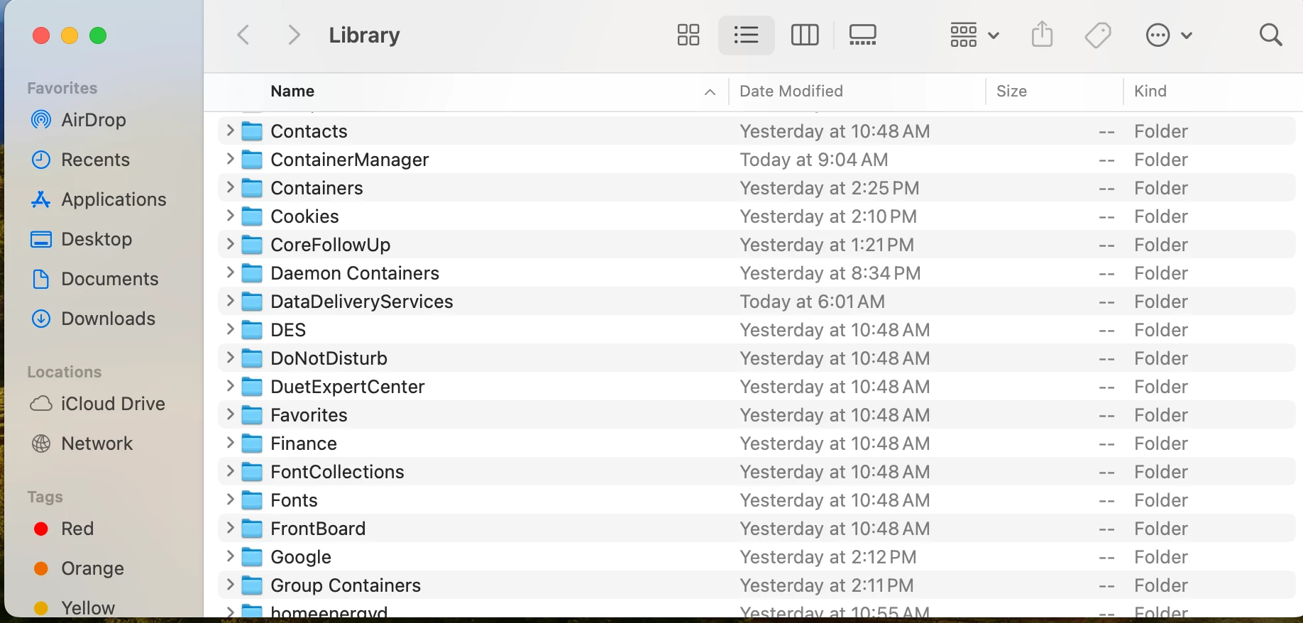

I was able to follow the directions noted above. When I enroll a device it does not kick in. Then I ran sudo jamf policy and received this error. It doesn't look like /Library/Desktop Pictures loaded.
