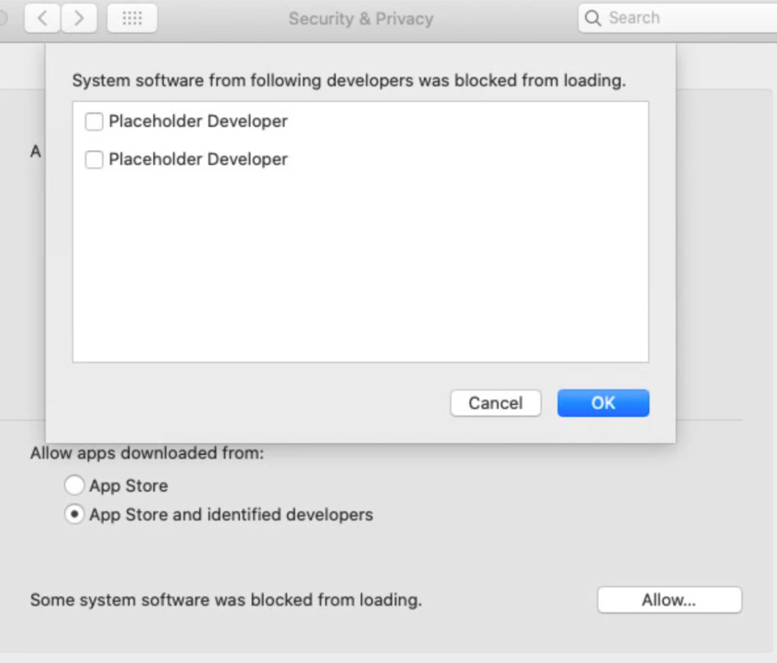

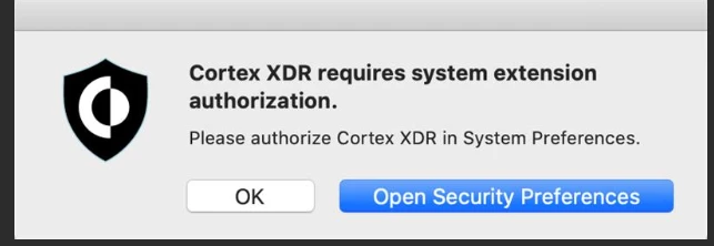

All,
I've followed the following guide to update our client to Cortex XDR from Traps 6.1.
https://docs.paloaltonetworks.com/cortex/cortex-xdr/7-1/cortex-xdr-agent-admin/cortex-xdr-agent-for-mac/install-the-cortex-xdr-agent-for-mac-using-jamf.html
I'm still getting the following message on some machines though. Has anybody seen this, and to why it's not accepting the Kernel extension Team ID provided by Palo Alto.
I'm thinking of reaching out to them to see if Cortex uses a different Team ID?

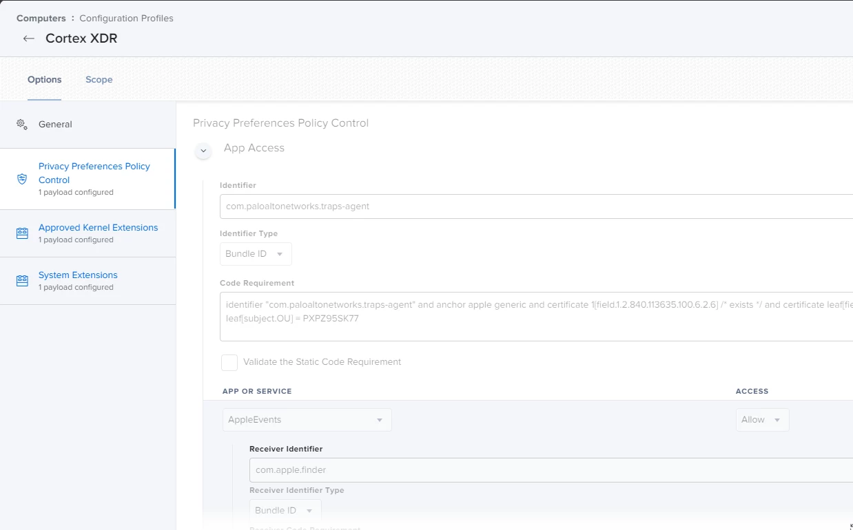

  • September 21, 2020
at the end of the palo document they refer to App Access but I don't find this tab nowhere under configuration profiles
geoff_widdowson
@nsoc-andrep This is a small screenshot of mine.
  • September 25, 2020
