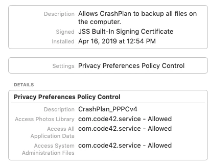

Bring this conversation back to life and I have created a profile with the PPPC utility and deployed to a test machine. CrashPlan is not backing up Photos on 10.14 even after deploying a PPPC profile. I've tried with the profile set to allow All Files and Admin Files, and then adding Allow Photos as well for the app location Applications/CrashPlan.app/Contents/Library/LaunchServices/CrashPlanService.app. I can backup and restore any pictures in the users Photobooth library but not the Photos Library. Scratching my head for 3 days battling this. Server and client are version 6.8.4, maybe a bug in that version? If I don't use the PPPC profile and grant full disk access to CrashPlan in System preferences, it works fine.

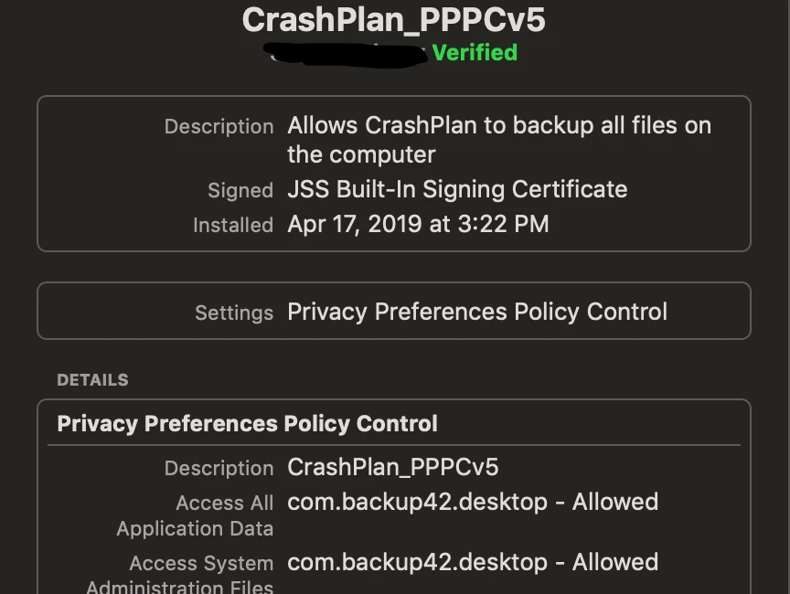

Here is a screen shot of my completed config profile if it's to use to someone hopefully. Built with the PPPC Utility. Issue with my previous config was I was using the wrong file path for the CrashPlan app.
