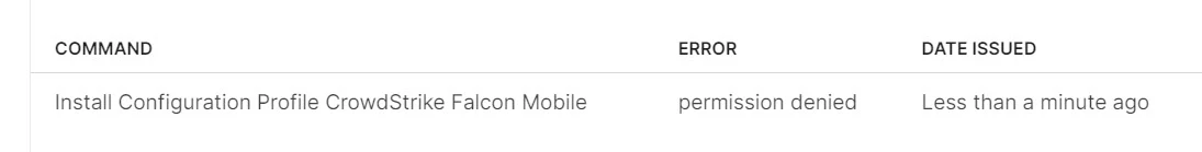

We are looking at testing CrowdStrike for mobile, we currently use Cisco Security (DNS Security & Endpoint Visibility)
I have created a new CS profile and when I first scoped it to one of my test devices I get Permission denied,  I can only get this to successfully install after I remove Cisco Security,  any suggestions on why both config's wont work on a single device,
appreciate it

I too am getting ready to install products similar to these for better endpoint visibility in the coming months; it makes sense to me that the you wouldn't want too and it is a bad idea© as they say to install two of these kinds of products at once. Wouldn't surprise me if the cisco product, sees crowdstrike and kills it. One at a time, I'd think.

I'm guessing they both hook into a system extension that does not allow for multiple configurations. Can you provide the configuration profiles you are deploying?
Hey, sorry for the delay but this was exactly the issue, once I got our security team to watch the logs as we implemented on a test device he was able to see Cisco kill the install process from CS.
