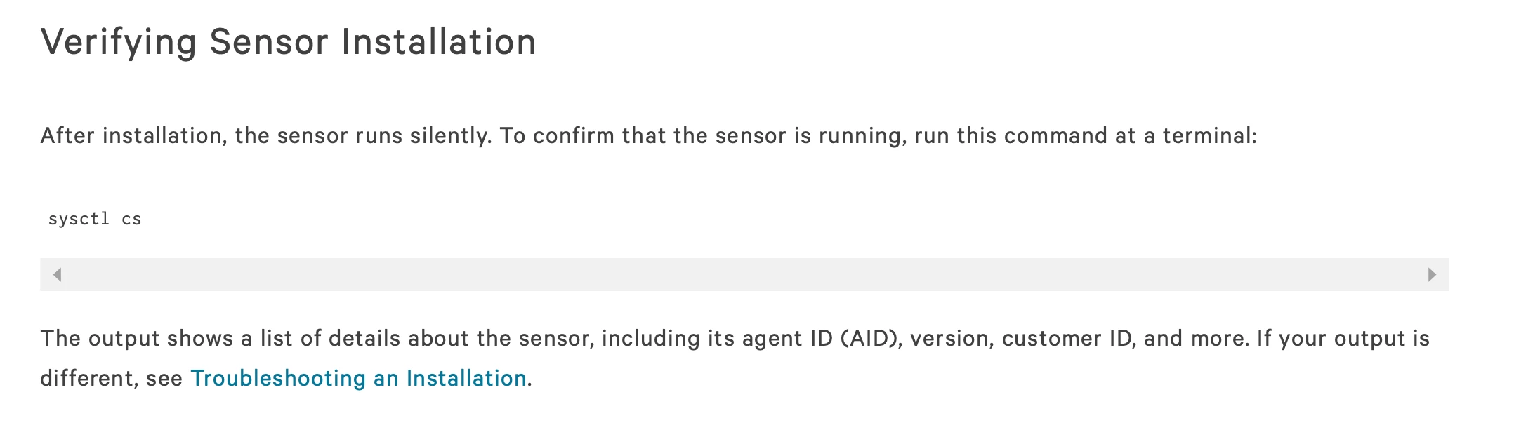

Hi is there anyone on here that has created a smart group for Macs that have CrowdStrike Endpoint protection installed? It doesnt install as a app so having trouble. Goal is to make a smart group to see which machines actually have it installed, since on my policy it says completed but in logs failed for some reason

We are actually looking at CS as well. I thinking of creating an extension attribute with a script using the command
sysctl cs
if there are no results i would say it didn't install correctly.
Their documentation says to use that command to verify the install.

Like mentioned, if you do a "sysctl cs" and get nothing, it's not installed right. I have the following EA setup to report the connection state of CS, it's either "connected" or "not connected:

We had issues with it not being properly activated post install. This can be seen by running sysctl cs, and getting nothing or an error like "invalid oid".
This occurred because our central IT department that manages CrowdStrike started deploying the pkg file without the licensing xml. We found out the hard way, after discovering several dozen computers that were not properly reporting a version #.
We built a script to run the license command after the installation, and an EA that checks for the existence of the License.bin file. The license.bin is created when Crowdstrike is properly activated. We then use that, a Smart Group and policy w/ check in trigger to run the licensing script.
