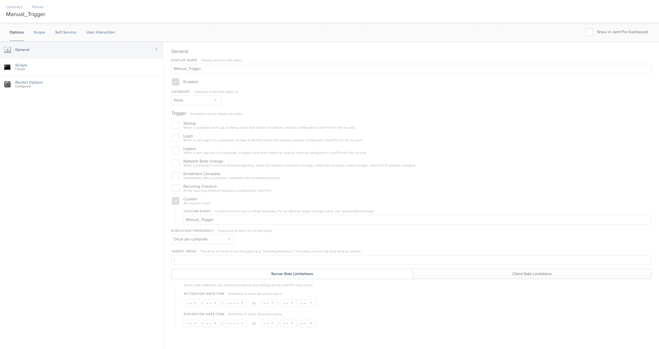

Hi.
I was wondering if there's a script available that will allow me to trigger all of my policies in the order I desire.
Uploaded my current script (not fully grasped the usage of scripts yet)
I'd like it to be a manual trigger for all of my policies but ordered e.g. 10GoogleChrome,20IssueFilevaultkey etc
Please help :D

There are a couple of things you can do here. You can build a global script that runs on enrollment complete, in this script you'd want to make sure that the user is actually logged in before the policies start running. (this sounds like what you're wanting to do, I've attached a script that I use, you can ignore the splashbuddy components.
or
To your first policy that runs at enrollment complete, add a files and processes payload to that policy. In your example, you have a custom event trigger set named to manual_trigger. So in the files and process payload in the last box you would type something like:
jamf policy -event manual_trigger
This will trigger the policy that you're calling, then in the next policy you'd add another file and processes payload to trigger the following policy and so on, this will set them off like a daisy chain.
