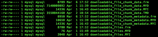

Ultimately, yesterday I uploaded a 7.14GB dmg... twice.. First time using Casper Admin - it took a while but when it was done, all was good - until I relaunched Casper Admin and found the file in red. I checked my JDS via CLI and sure enough, no file to be found. I decided to re-upload the file using the JSS interface. It took some time as well and sure enough, it still did not appear in the CasperShare folder in CLI.
After some research, I found that the JDS needs a /tmp folder larger than what we typically allocate - fine, issue resolved using a symlink to the /data partition.
Now however I've noticed my Database is unresponsive - can't stop MySQL or login to MySQL. Each JSS server is stuck at 'Initializing Database' after a quick restart. Browsing the mysql/data/jamfsoftware in CLI, i've found some large files - about the size of my DMG.... (Picture attached.)
The first question that comes to mind is WTF are those doing there, but putting two and two together, I imagine uploaded files traverse the DB before hitting the JDS - and because my JDS couldn't replicate, they were stuck there - and because of their size, our /data partition is now full - and because our /data partition is full, MySQL has become unresponsive...
help...

Not going to currently help you but yeah, that is how uploading files to the JDS works. The files go onto a temporary location on the hard drive in the Tomcat directory, then the file gets pulled into the database in the downloadable_file_chunk_data table, and then the file gets pulled down to the main JDS then replicated from there. Its....not the most efficient thing.

Can anyone confirm if removing the two astronomically-sized files via CLI is a good idea? Maybe follow that up with killing the running mysqld process and then launch mysql again?
  • April 2, 2015
Definitely DO NOT do that. You never want to manipulate the raw database files like that. You will corrupt your database.

Thank you both for your input. A somewhat convoluted solution was to increase the size of the /data partition and restart the process - at least the DB is back online. As for these files - I hope now that the JDS /tmp folder is more accommodating to their size, they'll get out of my DB on into the JDS. Time will tell...

JAMF support came back with the following;
truncate table downloadable_file_chunk_data; truncate table downloadable_file_chunk_metadata; truncate table downloadable_files; Then repair and optimize the database and restart tomcat.
As for repair and optimize, I ran:
mysqlcheck -u root -p --auto-repair --all-databases
mysqlcheck -u root -p --optimize --all-databases
The issue appears resolved. I'm re-uploading the file now - with a larger /tmp folder on the JDS, there should no longer be a bottle neck...
