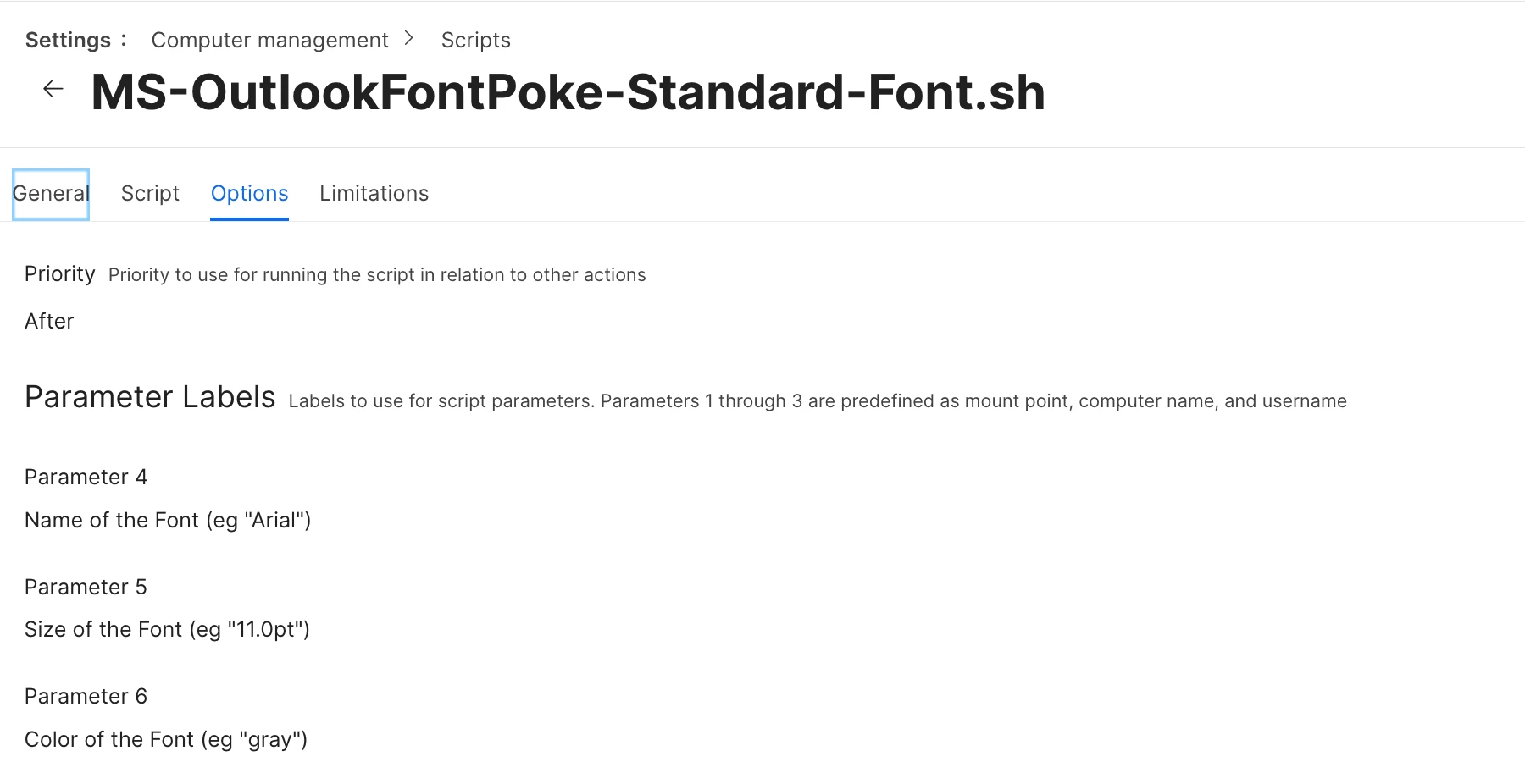

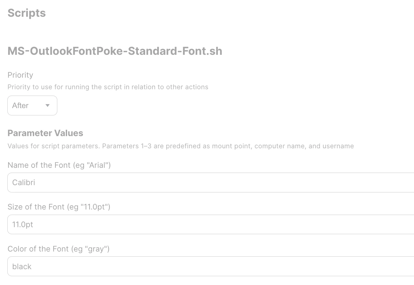

I used a newer Version of the OutlookFontPoke from here:
https://github.com/AlyaKoni/OutlookFontPoke/tree/master
I created a PKG for that script which installs into
/usr/local/OutlookFontPoke/
My Script for setting up Font parameters via Jamf Policy:
#!/bin/bash #send command to OutlookFontPoke v2.1 by Paul Bowden #https://github.com/pbowden-msft/OutlookFontPoke/archive/refs/heads/master.zip #pbowden@microsoft.com # Variables nameFont=$4 #eg "Arial" echo "### nameFont - $nameFont" sizeFont=$5 #eg "11.0pt" echo "### sizeFont - $sizeFont" colorFont=$6 #eg "gray" echo "### colorFont - $colorFont" pathToScript="/usr/local/OutlookFontPoke/OutlookFontPoke-2.1.sh" #Get Current User loggedInUser=$(/bin/ls -l /dev/console | /usr/bin/awk '{ print $3 }') echo $loggedInUser " is logged in" #fix permissions chmod +x "$pathToScript" # Run command as current logged in user sudo -u $loggedInUser $pathToScript $nameFont $sizeFont $colorFont exit 0
My settings for the Script in the Jamf Console look like this:
 And the Policy settings are like this:
The Script runs once per day and log in, this ensures that things are ready before Outlook starts.

I didn't think so but I wasn't sure if triggering it from Self Service might run it AS the user.
Anyway, it worked for me without creating a package or any of that extra stuff though. I just used the original (https://github.com/pbowden-msft/OutlookFontPoke) but changed lines 125-127:
FONTNAME="$4"
FONTSIZE="$5"
FONTCOLOR="$6"
I did it on my user, which already had Outlook setup and everything, I just changed all the font preferences before running it. I just feel like I must be missing something, because I'm not that good of a script writer for it to be that easy of a fix.

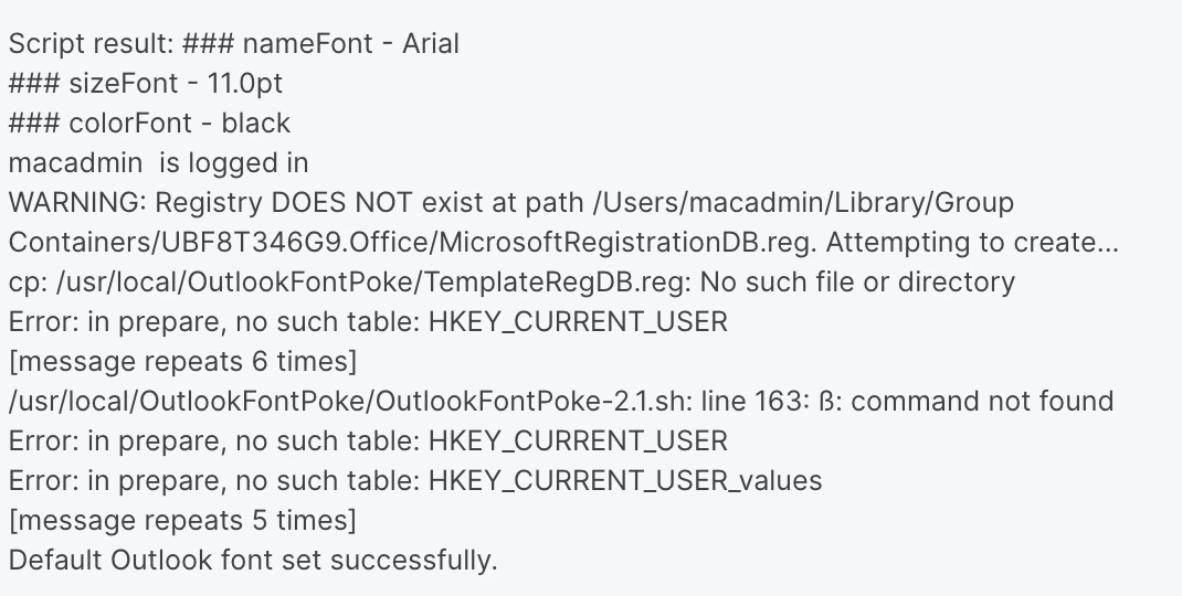

@Bretterson I run the policy on Macs which have MS Outlook already installed and with the Trigger Login. As far as I found out, it is only requires to have the Outlook App installed, it is not required to have Outlook already configured with an account.
Hmmm. I still can't seem to get it working before an account has been added to Outlook. The script creates the file without issue, but the application doesn't take the changes. The file permissions match the ones that were on the the copy of MicrosoftRegistrationDB.reg I had prior to using the script (as in the file Outlook generated back when I added the user).
Are you using the App Store version of Outlook or a standard installer? I wonder if it behaves differently.
EDIT: I tried uninstalling Outlook and letting Jamf reinstall via Jamf App Installers rather than MAS, still no luck 😖

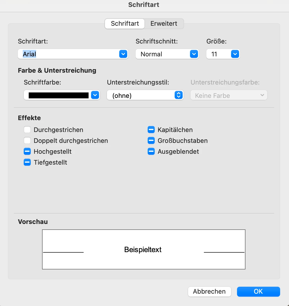

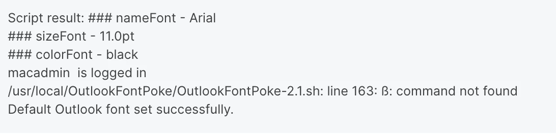

@Bretterson we use the Office PKG Installer. To get my workflow to work, it is not required to have a Profile in Outlook.
In case Outlook is not installed I get the following log:
 After installing Outlook the script shows an error:
Then I activated Outlook and created a Profile, the result in the Outlook Settings are like expected:

Jamf App Installers looks to be using a PKG installer as well, so that probably isn't the issue.
I actually modified the script to download the TemplateDB.reg directly from GitHub and use parameters from a Jamf policy. All of that is working fine... other than the messages that the registry and registry path don't exist, I don't get any errors at all, regardless of whether I run it with or without Outlook installed. But for some reason Outlook doesn't process the changes unless I run it after an account has been added. Maybe I'll see what happens if I just run it locally. I don't want to give up but I'm low on ideas.
PS: You can delete line 163 from the script, it seems to be an errant character.
