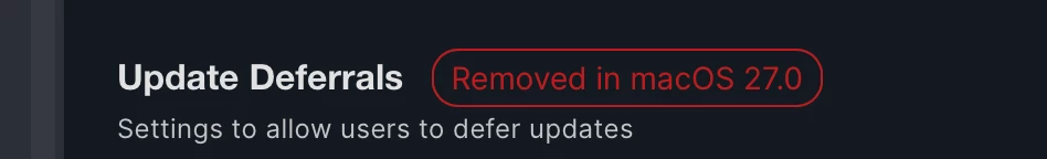

Did not set deferrals, but had all our Macs set to update to a specific version (was 26.6.2). Yesterday Macs were showing that they were already on the latest allowed version of macOS for our organization. Today they’re offering macOS 26.7 and 27 - ridiculous.
This year I created a new Config Profile just for the Major Deveral and it looks like that it works for now, keep fingers crossed 👍

That will change next year for iOS/macOS 27.
BCPeteo
  • Sep 15, 2026 3:16 PM UTC
Yes we know this that's why we are asking Jamf to get the DDM Major block setting into Jamf pro on prem since we do not have access to Blue Prints.

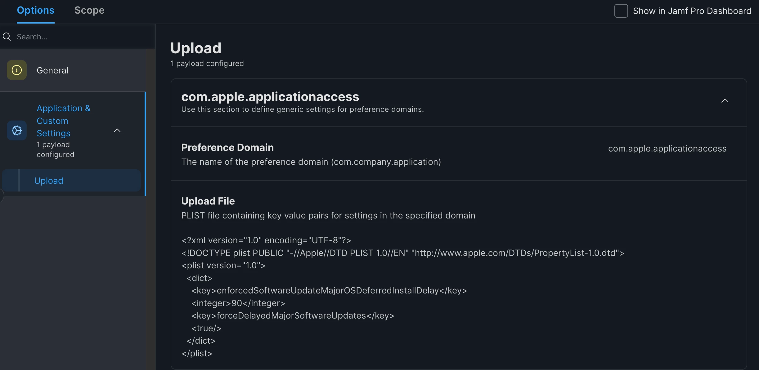

​@jamfdude could you post the code of the Software Update CP here?
I would create a plain new CP which just contains the setting for the major software update and push it to all clients. Check if there is any other CP which might contain the same setting and disable it.

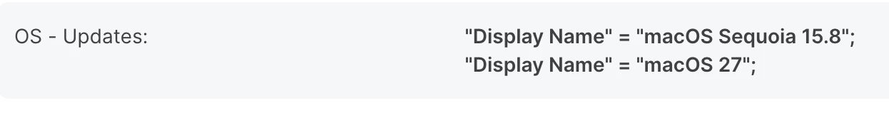

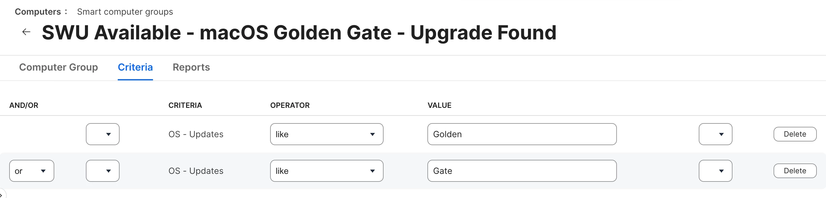

​@jamfdude Maybe the following EA helps you to find Macs in your fleet who get the macOS Golden Gate offered. I use it for a Smart Group which lists me Macs:
EA: “OS - Updates”

The Smart Group looking for Macs who get macOS 27 offered:

here’s the profile
there is nothing else in it but this restriction
there is another profile @ “/Library/Managed Preferences/com.apple.applicationaccess.new.plist” that is setting “familyControlsEnabled = false” the source of which I”m unsure of. I asked JAMF support about if that would be in conflict given it starts off with the same com.apple.applicationaccess but they said no b/c it’s in a different preference domain
I also find the 2 deferred keys in com.apple.SoftwareUpdate which I think is from when it used to be an option that could selected in JAMF via a check box and then filling in the # of days in a form field but I believe that’s been (re)moved from the UI but probably still exists in the profile payload from when it was available. I don’t think that should be in conflict either as it’s also in a different preference domain.
thanks for the EA idea, I was going to take a poll but will just wait for this to report in from the fleet instead. It won’t help stomp out the issue but will at least give me an idea as to its scope.
Restricted Software only works to stop clients from running the full installer and unfortunately cannot block a “detla” install like the one seen in the software update preference pane. Oddly, JAMF support recommended this too and I had to explain that to them which doesn’t bode well IMO. They’re now transferring my ticket to engineer because they cannot reproduce my issue.
​@JevermannNG FYI your smart group might need to be modified. On my unit the EA reads “macOS 27” when macOS 27 shows up in the SU preference lane. A regex for .*macOS 27.* should do the trick

​@jamfdude  Thank you for the hint!
I can confirm that Macs running on macOS 15.7.5 get macOS 27 offered.

I don’t believe JAMF is modifying the profiles here, but my JAMF instances are setup to sign all profiles. JAMF support was able to identify a misconfiguration on my instance that is/was likely the source of the leak that caused this issue. There was a second profile that pushed a restrictions payload and in the “Functionality” tab of that one is where the checkbox & form field I was referring to here can be found:
Unfortunately the person who created this particular restriction profile didn’t check that box so I think it was overriding the other profile which was setting the override via “Application & Custom Settings”
However, despite fixing that issue the update is still shown. JAMF support advised to use this command to check the state of the override:
osascript -l JavaScript -e "$.NSUserDefaults.alloc.initWithSuiteName('com.apple.applicationaccess').objectForKey('forceDelayedMajorSoftwareUpdates').js"
but despite it saying true the update is still shown in the softwareupdate preference pane. JAMF support also advised to kill softwareupdated & wipe out everything under /Library/Updates and try to refresh the updates but this cannot be done I believe due to SIP.. I also tried disabling SIP and then doing this but even after that checking for updates found/displayed macOS 27 so I’m waiting to see what support has to offer next.
