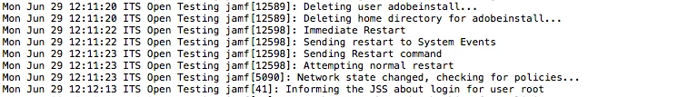

My question has to do with Casper imaging and the JAMFHelper splash page that reads "The Imaging Process is finishing installing software".
I currently have a recurring Adobe CC 2015 policy that kicks off during that splash page. My issue is that Casper Imaging reboots the machine (immediate restart) halfway through the policy, before some of the software is finished installing. This means that the software has to finish installing at the login window (not ideal). Is there a way to delay the reboot until the policy is completed?
Or, can I manually trigger the splash page via "At Reboot" policy then have a command at the very end to reboot?
The reason I want to do this is that Adobe CC fails to install without someone logged in. At the JAMFHelper splash page, the account "adobetempinstall" is logged in.
Thank you all!
Immediate Restart after Splash Page:

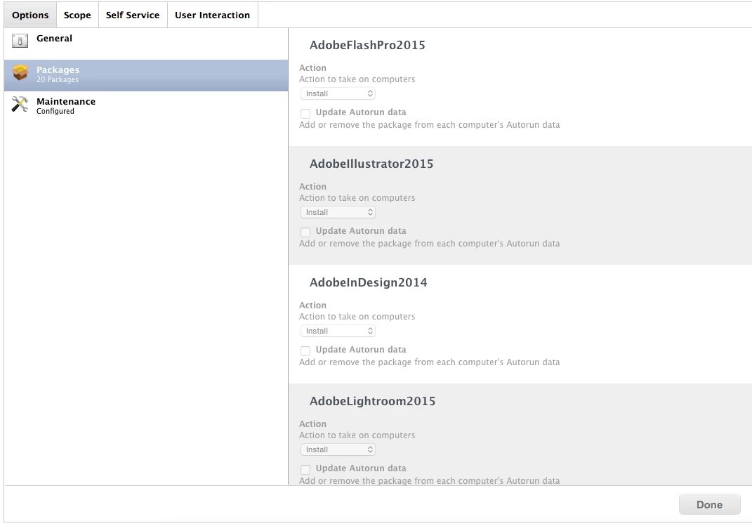

Yup! But Adobe CC is not part of the configuration, but part of a policy.
Examples:
Install on Boot drive after imaging
Example policy:

That said, I am still not sure what's happening, but I would want to see the policy's General pane.

That's your issue. The script is not executing as part of any imaging actions, it's a result of the normal launchdaemon's recurring policy check as a separate thread. The firstrun script is not waiting for the policy to complete before rebooting because it is not triggering that policy, and is unaware it should wait for it.
You could include a script that runs towards the end of the imaging process and checks to see if the Adobe apps are needed, then runs a trigger policy to install them if they are. The reboot would wait for that to complete.
