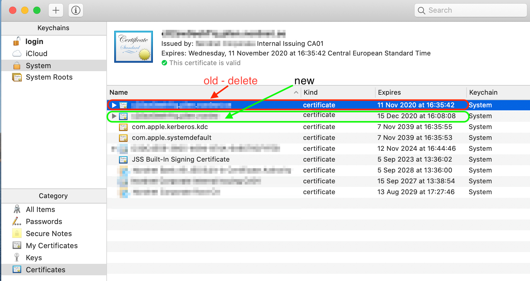

Hello,
Is there a way to delete duplicate certificates? - Today we push out our AD & Wifi certificate with a configuration profile, and had to do some minor changes on the settings for the certificate.
The result is we now have two certificates with exactly same name $SERIALNUMBER.Domain.Companyname.com
and we would have to delete the older one, something like "...delete certificates created before December 16th.."
Is there any "smooth"" way to do this?
Best answer by Gonzalo
Following script worked like charm for me!
Thank you @AdamMartin

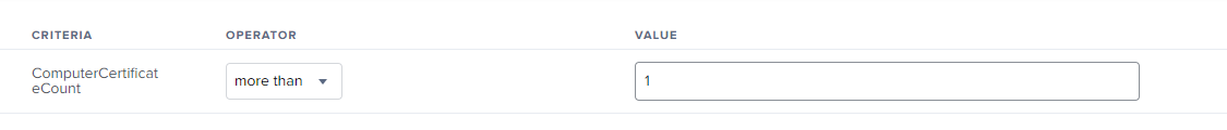

Thanks for this script! We issue certs to the serial number of the device. Is there a way to put in a variable for the certSubject? I would like to make that the Serial Number of the device. Thank you again! This script is awesome! @Gonzalo @AdamMartin
  • Nov 3, 2020 7:30 AM UTC
This script is awesome. How do you scope this policy? Is there a way a build a Smart Group with clients having duplicated certificates? Actually I found only a way to make a smart group with clients that have installed a common certificate but can not limit this to duplicates.

Use it together with this EA and create a smart group.
#Get current number of Computer Certificate
#Current ComputerName
ComputerName=$(/usr/sbin/scutil --get ComputerName)
ComputerCertificateCount=$(/usr/bin/security find-certificate -a -c $ComputerName -p -Z "/Library/Keychains/System.keychain" | grep SHA-1 | wc | awk '{print $1}')
echo "ComputerCertificateCount"
echo "<result>$ComputerCertificateCount</result>"
Once again, thanks @colorenz

Forum|alt.badge.img+27
  • Jul 19, 2021 2:50 PM UTC
Use with caution.  The script looks a lot like one provided to me by Jamf support.  I've recently discovered that it does review all certs based on computer name and keeps the one with the longest expire date.  Unfortunately, a few Macs have had certs that have the name of the computer, but are self-assigned or issued by things other than our ADCS services.  One I stumbled on was a cert that was self-assigned by CUPS.  The result is that every ADCS PKI cert was removed but the Self-Assigned remained in place because it had the longest time to expire.
