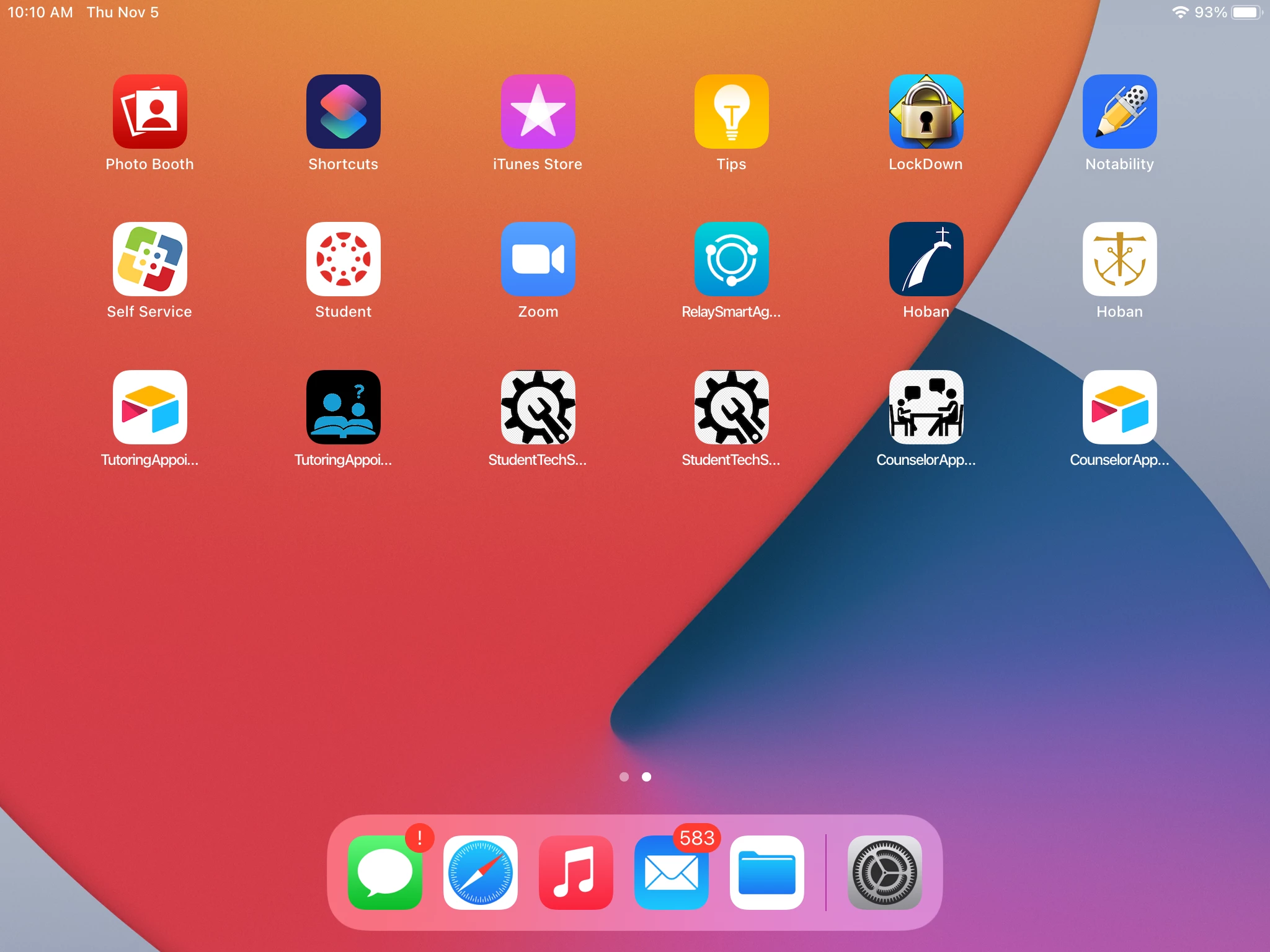

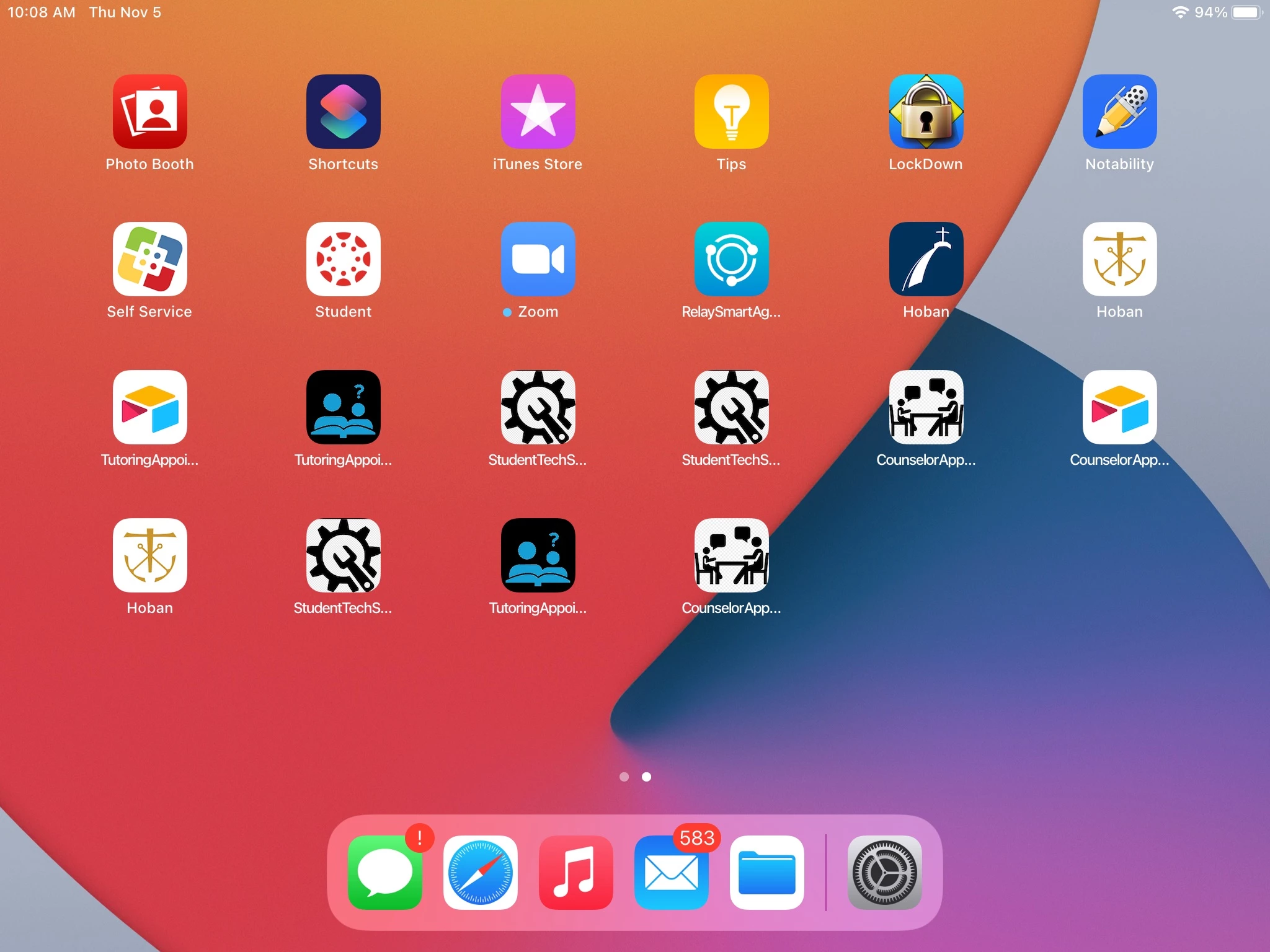

I am encountering the same issue. I have a set of webclips from a configuration profile that has stuck around. In fact there are two sets of webclips. I deleted the config profile and they hang around. I have readded the config file but that just adds another set. When I remove the config profile, only one set of webclips disappears. I have tried just about everything short of wiping the device. Just wanted to let you know misery loves company.
  • Nov 5, 2020 6:48 PM UTC
