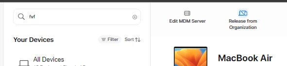

piotrr
  • February 8, 2023
Sign in to Apple Business Manager with your management AppleID.
Click Devices.
Search for the serial number of this device.
Click Release from Organization.
