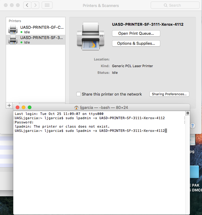

franton
  • Oct 25, 2016 10:05 AM UTC
@jamfmdm Ok what happens if you just run this on a terminal window?
sudo lpadmin -x UASD-PRINTER-SF-3111-Xerox-4112
  • Oct 25, 2016 10:17 AM UTC
@franton This is what happen.
franton
  • Oct 25, 2016 10:18 AM UTC
Ok interesting. What's the output from
sudo cat /etc/cups/printers.conf
  • Oct 25, 2016 10:56 AM UTC
@franton i got it. it should be GF_Printer_SF_3111_Xerox_4112 for the printer name
franton
  • Oct 25, 2016 10:59 AM UTC
Excellent. I had a feeling it was something like that.

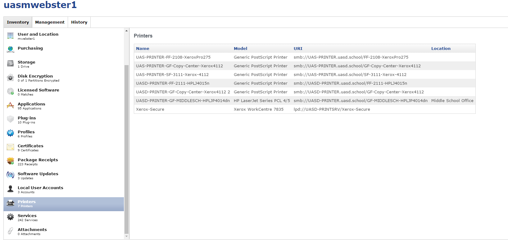

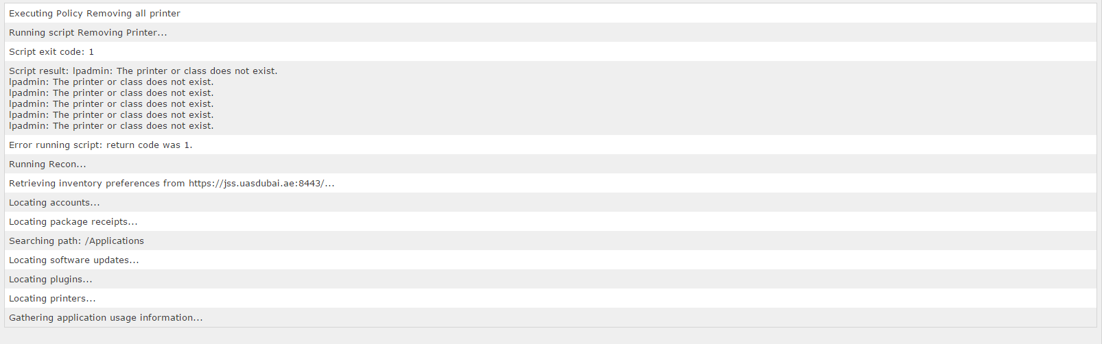

  • Oct 26, 2016 6:07 AM UTC
@franton hello i have one more question. i made the script something like this
lpadmin -x UASD_PRINTER_GF_Copy_Center_Xerox4112
lpadmin -x UASD_PRINTER_SF_3111_Xerox_4112
lpadmin -x UASD_PRINTER_FF_2108_XeroxPro275
lpadmin -x UASD_PRINTER_SF_312A_HPLJ4014
lpadmin -x UASD_PRINTER_MPH_M12_Xerox5845
lpadmin -x UASD_PRINTER_GF_Copy_Center_SharpColor_MX_5110n
this is the printer we want to remove to all the teacher, but some printers are not installed to teacher laptop and some are installed, but for some reason when i push the policy most of the macbook is failed and this is the error message that is showing.
franton
  • Oct 26, 2016 6:18 AM UTC
Yes that will happen if you attempt to remove a printer that doesn't exist on the system. You will have to script around this.

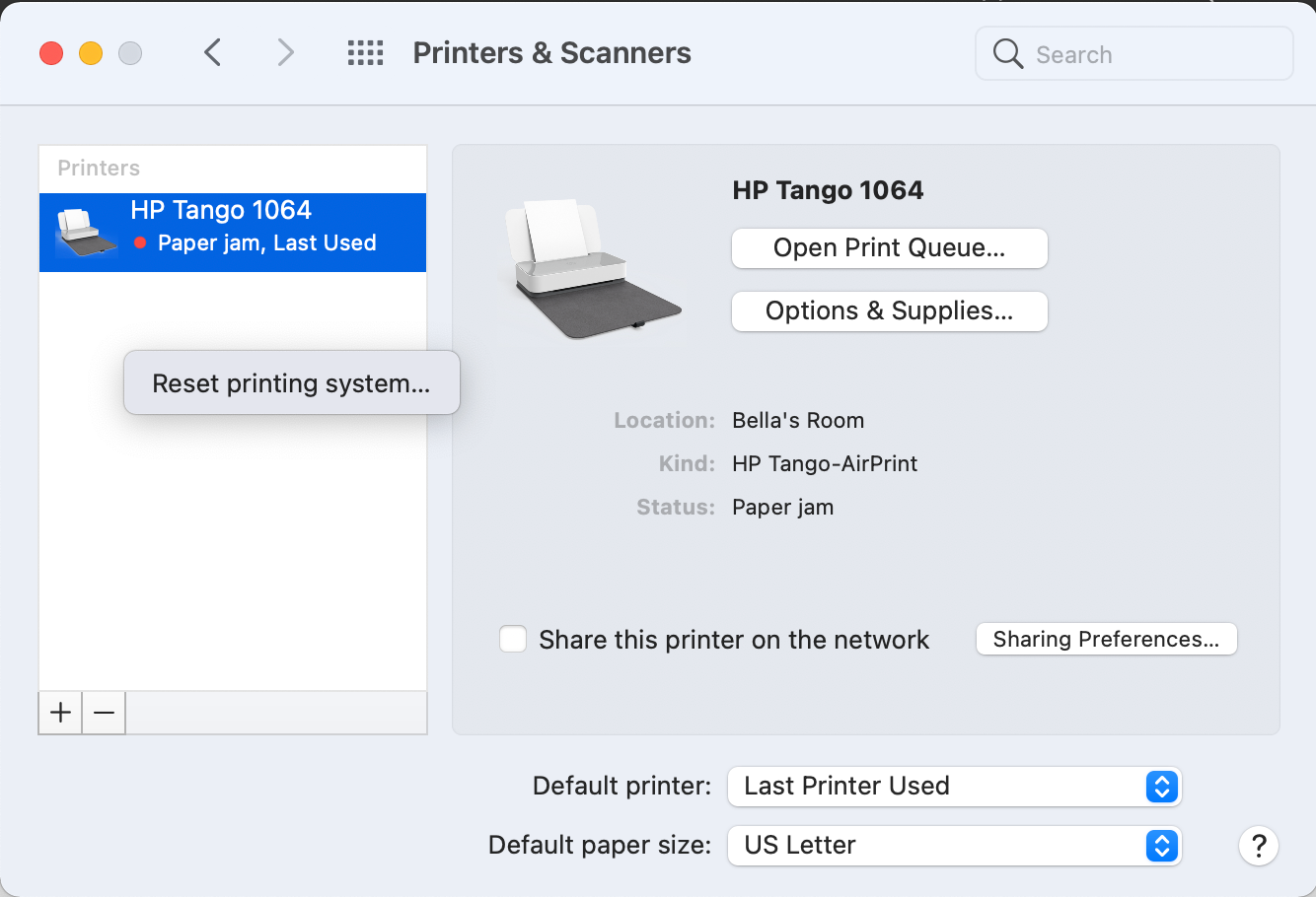

Follow up to my original answer. If I just want to nuke all printers, i'm now running this:
/System/Library/Frameworks/ApplicationServices.framework/Frameworks/PrintCore.framework/Versions/A/printtool -f --reset
scottb
  • Aug 25, 2021 9:50 PM UTC
@franton - is this the same as Control-Clicking within the Printers section of "Printers & Scanners" and selecting "Reset printing system..."?
franton
  • Aug 25, 2021 9:56 PM UTC
Precisely that!
