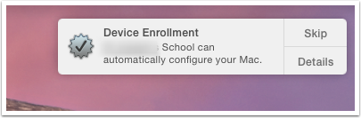

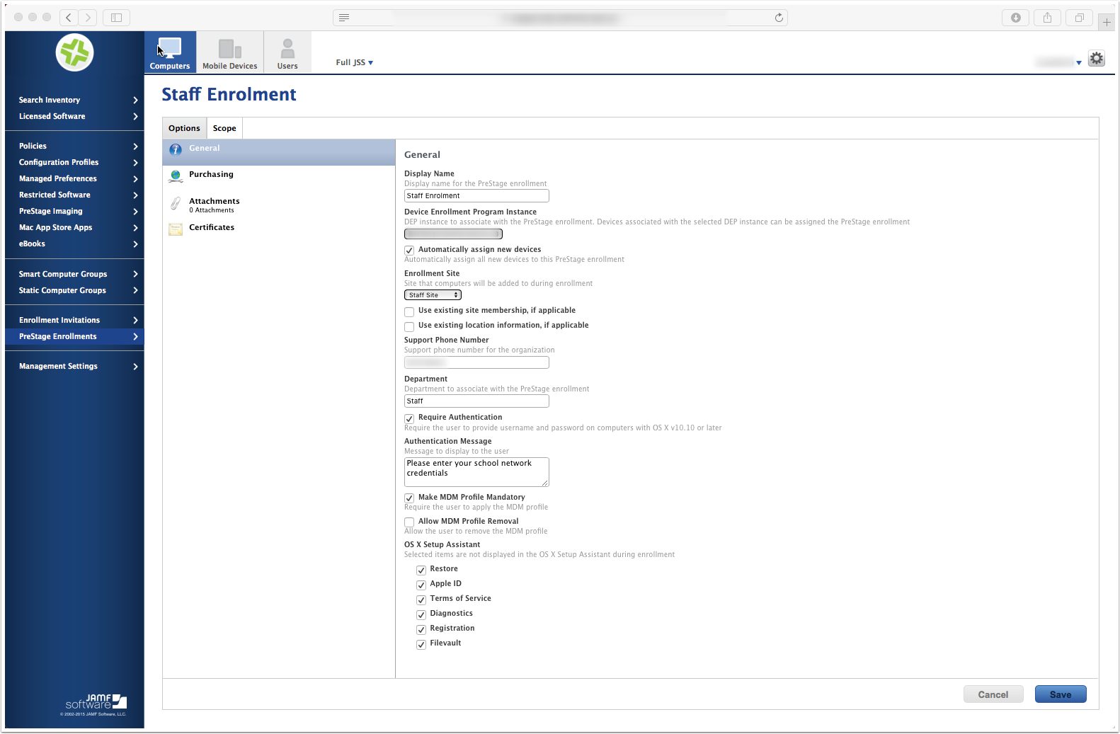

I'm just in the process of testing a DEP rollout for new devices.
The devices are hitting the preStage Enrolments they are assigned to but don't;
  1. Skip items defined in the "OSX Setup Assistant" payload
  2. Force the MDM profile to be installed

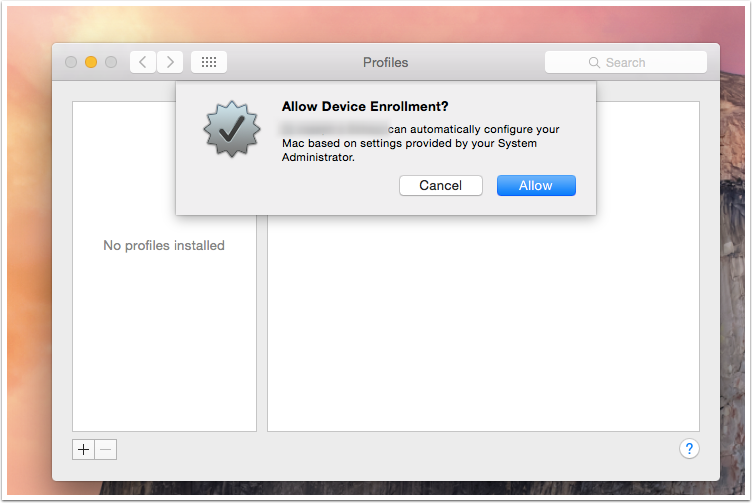

Once the machine has run through the Setup Assistant, the users is prompted via a Notification that Device Enrollment is available, but not enforced.
I have tried a few different PreStage Enrolments, with changes to the "Require Authentication" but this didn't change the outcome.
Any thoughts on this or other users experiences would be much appreciated.

@d4mo1337 I remember reading in another thread about a problem with enrollment of OS X devices if Make MDM Profile Mandatory was checked. When I tried testing DEP on a Mac OS X system I couldn't get it to properly enroll either. I had the Make MDM Profile Mandatory option enabled. I didn't test with the option off so I am not certain that would have solved my issue. Can you try unchecking that option and trying again to see if it works like you expect? Of course, un-checking that option is a less than optimal choice in my opinion so I pretty much gave up on using that method until this issue is resolved.

I haven't updated to 9.81 yet but, it now appears to be working now. The changes I made were to; Backup the JSS database
un-tick and re tick the "Make MDM profile Mandatory"
remove the computer from the PreStage Enrolment scope, and add it back in
I will do some more testing, to pin point what (dare i say it) the fix is/was.
@anastnic Thes are newly delivered laptops, I have been re-imaging the test machines with a never booted capture taken from one of them. Once you click the Notification item it does install the MDM profile and is fully enrolled and managed in the JSS.

Our issue is more around the Device Enrollment OS X notification.
Essentially only half of our computers were purchased with DEP, the others predate our Casper setup.
We're trying to enroll everyone in to DEP without creating that notification
  • February 2, 2017
@Bongardino We had an issue with that recently as well. A JAMF engineer basically explained that a flag was suppose to be turned on after a machine has been DEP'd successfully. This is stored in the /var/db/.AppleSetupDone file. However; when that flag gets removed for whatever reason, client machines will start displaying Device Enrollment OS X notifications. The client essentially is contacting Apple constantly thinking it needs to DEP the machine.
To remedy, we need to remove that machine(s) from your PreStage Enrollment so it no longer tries to DEP. Then we need to re-run the Apple Setup Wizard, but this time, when client contacts Apple for activation, it will just activate normally and not think it needs to go through DEP. After that is all done, you can re-add the machine back into your PreStage Enrollment in case it needs to get imaged again in the future.
