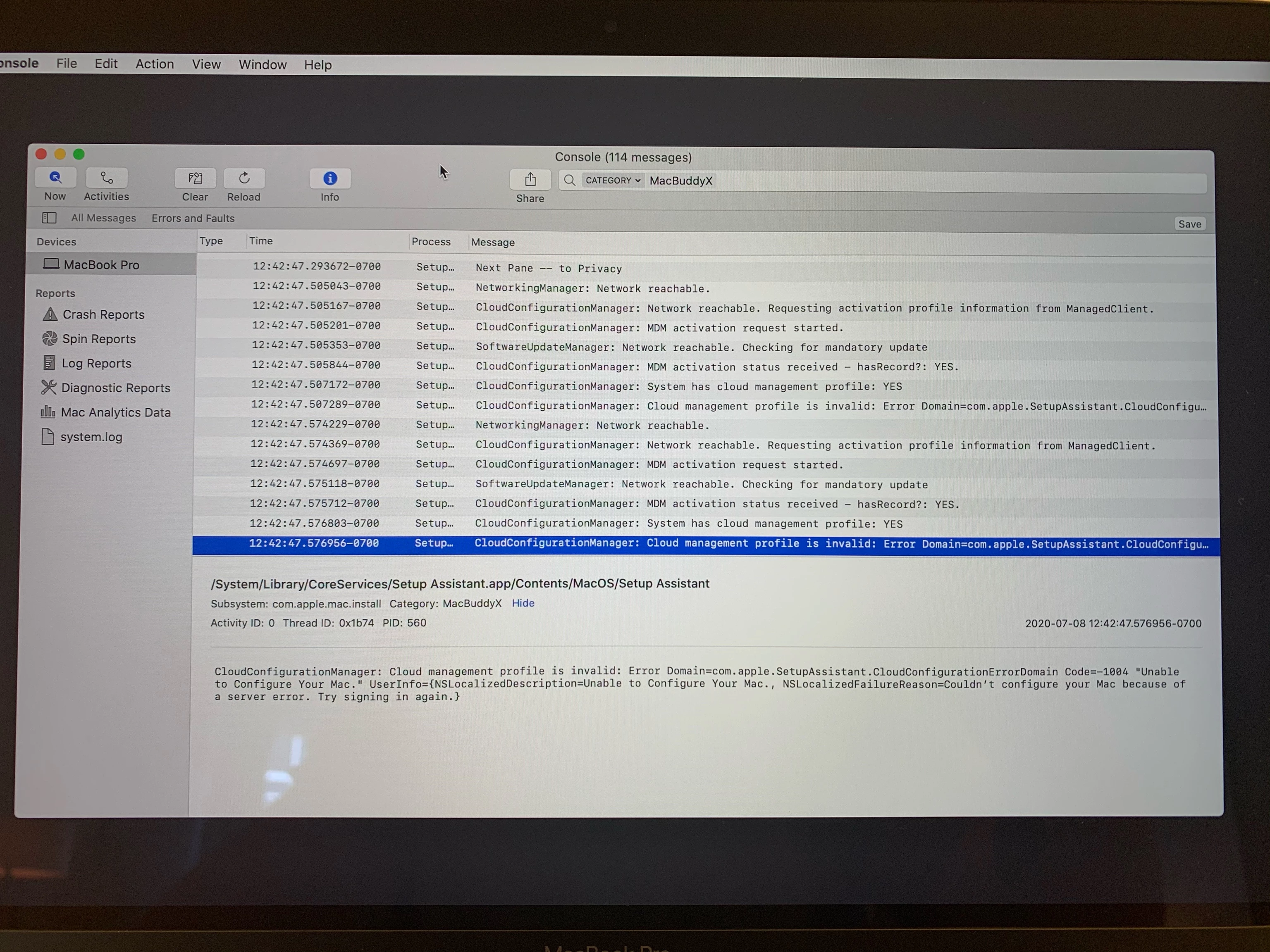

Hi Folks, this issue was hard to diagnose as we didn't see anything in the logs on either the JSS side or the client side pointing to the problem.
The issue is the root CA cert, which in our case was from InCommon.
What we did to fix it was 1) generate fresh SSL certs, then 2) create the Tomcat P12 cert, 3) move the certs into the correct location on our JSS, and 4) stop and restart Tomcat.
You can test to see if your server has this problem by using the following command:
openssl s_client -connect yourjss.example.com -port 8443
Run the above command from a Mac or Linux machine (don't know how to do this in Windoze).
In the Certificate chain section, if you see the words "AddTrust" then you have this problem and need to fix it.
For example, you'll see "AddTrust: in the last three lines here:

New fresh out of the box 2020 Macbook Pro 13in not receiving assigned pre-stage. Interesting error, also on ethernet. Yes it can be fixed with a wipe/reinstall just seems kinda lame for a new employee to have to do :/. I am wondering if there are any kind of tricks that can be done when using terminal.
I'm running into this issue as well with any 13" mac laptops that are prestaged in my environment. @dniven I've tried using the command you suggested, but receive the following error in terminal, "no port defined; usuage: s_client args". Any suggestions?
