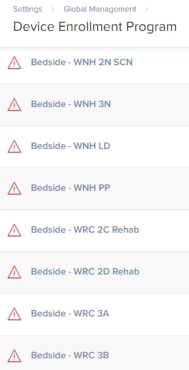

I recently had my Jamf instance moved to a new server. Then I noticed I started having problems with my DEP syncing in Jamf. Devices that were added to the DEP pre-move would setup correctly but new devices added after the move wouldn't start the DEP process. When I go to the Settings/Global Management/Device Enrollment Program my account has a red triangle next to it. In the settings of my DEP account there's an error that says 'Sync failed. Awaiting next sync'. When I open Apple School Manager and download the token, I receive the following error when I try to import the server token file into Jamf 'The file received was not valid'. Has anyone come across this error before?

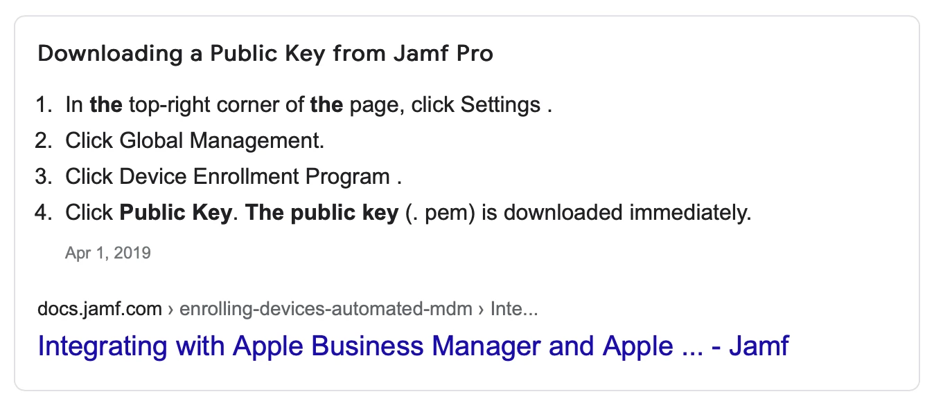

Same here. JSS alerted me to the fact that my server token file is expiring. I downloaded a new server token file from Apple, and I received the same error when I tried to upload the new token file in JSS.
EDIT: I had to replace the public key for our MDM server on school.apple.com, but now JAMF won't upload the server token file and throws an error about "Unable to contact https://mdmenrollment.apple.com to get the list of devices".

Re-uploaded the public key to the MDM entry on school.apple.com, re-downloaded the token and it uploaded correctly. I did restart tomcat prior to re-uploading the public key, so I'm not sure if that was needed to fix the issue.

Having similar issue since the upgrade. Every server on my DEP screen has a red triangle next to it reading "Sync failed. Awaiting next sync".
Occasionally they will go away, but after a while they come right back.

I was having the same issues as everyone else. Rebooted Tomcat, the public key, and server token, and still nothing.
I spoke with Jamf Support and they suggested signing in as a different admin under Apple School Manager to reload the key and server token, and it FINALLY worked.

I confirm similar behavior. We run JAMF 10.12 and to resolve this problem, I have to go to ASM and upload the public key again and download the token. Once this is done then JAMF will accept the new token.

I was having this problem and tried restarting Tomcat, but it didn't work until I uploaded our public key into ABM again.
