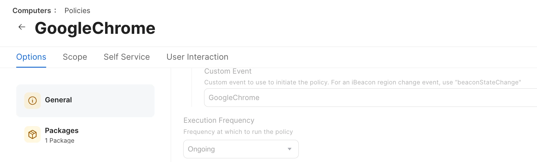

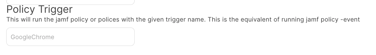

Hi ​@gwhaley262 ,
Maybe you missed this part:
JSM installs the package through Policies using the Custom trigger at a custom event.
Name the custom event according to the package name (for example: GoogleChrome)..
Then, add it to the JSM section under Policy Trigger.
