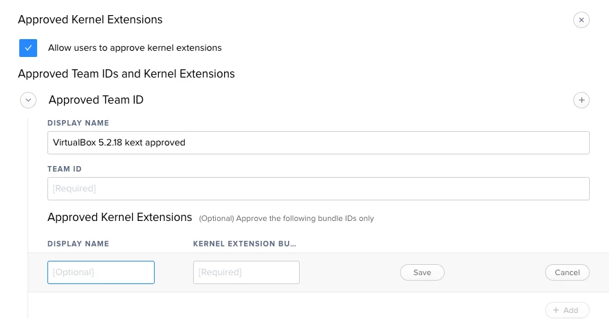

I am having issues with the VirtualBox being loaded. I create the package, but it does not run without the app being approved in privacy and security, which in our environment is blocked.
My questions are: What is the Team ID?
How do I locate the Display name?
And the Kernel Extension Bundle?
Are there any JAMFers that can help me learn where to locate these items?
Thanks all,
~r

@Hugonaut that is awesome.
When I use the SQL Select function do I want to name it directly or just let it run its stuff and I can locate it?

@rhooper yes it is. After you asked, I went looking and couldn't find anything, figured what the hay, I've looked before & I'm sure a lot of other jamfers have...
To answer your question Just run the commands exactly as typed, it will pull all KEXTS and associated IDs in the database and then you can add them, you don't need to name anything directly
  • October 12, 2018
@Hugonaut Worked like a charm. Now I can push out the VBox app. Thanks
