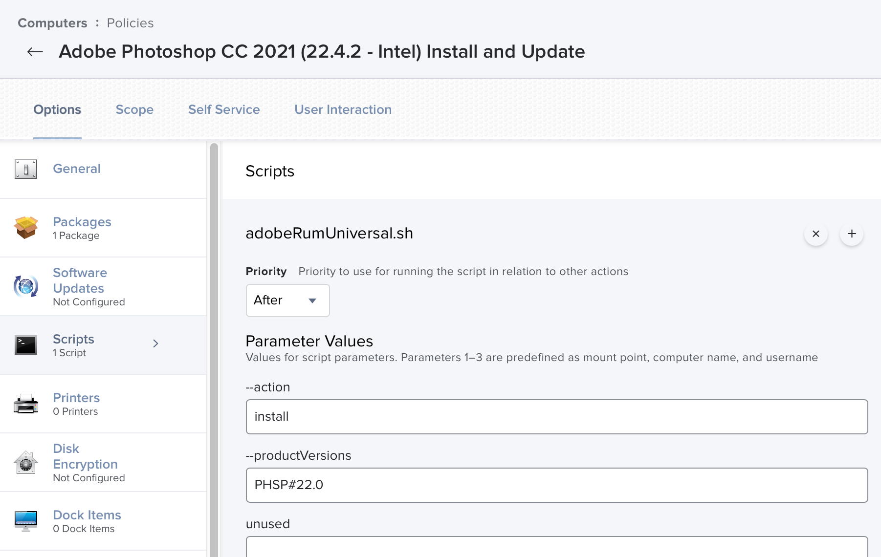

marksf
  • May 22, 2023 4:42 PM UTC
@mnordbye : Sure! This script will work if you've enabled Adobe Remote Update Manager in the admin console when you build the packages.
The Script
adobeRumUniversal.sh
# Runs Adobe RUM to manage Adobe Application updates
# Parameters available in Policies
# $4 = --action Options: list, download, install
# $5 = --productVersions see:
#      <https://helpx.adobe.com/enterprise/package/help/apps-deployed-without-their-base-versions.html>
if [[ -f /usr/local/bin/RemoteUpdateManager ]]; then
  echo "Starting Adobe RemoteUpdateManger..."
  /usr/local/bin/RemoteUpdateManager --action=$4 --productVersions=$5
else
  echo "Adobe RemoteUpdateManager not found."
This script has two parameters:$4 = -action
Specifies the action to be performed: list, download, or install.
  • -action=list: Displays a list of applicable updates for the products installed on the machine.
  • -action=download: Downloads the applicable updates.
  • -action=install: Installs updates if they are downloaded already. If the updates are not already downloaded, this command first downloads the updates and then installs them.
  • If --action is not specified, the command performs the default action and just downloads and installs the applicable updates.Note: The --action command line option currently does not support the download of updates for Acrobat and Reader.
$5 = -productVersions
SAP Codes
Adobe's full list of base versions and SAP codes.
marksf
  • May 22, 2023 4:51 PM UTC
The Script
else
SAP Codes
I should note that this script is specifically for use with Jamf policies.
We can use this one script to install and / or update the base version of most Adobe apps.
Options
  • Packages: Installs Adobe Photoshop base version of 22.0 (or later)
  • Scripts: adobeRumUniversal.sh
    • Parameter --action = install (checks for, downloads & installs available updates)
    • Parameter --productVersions = PSHP#22.0 (limits “action” to base version 22.0, i.e. CC 2021)
  • Maintenance: Update Inventory (when done)
Scope
  • Targets (Smart Groups)
    • Create a group with criteria - App title = Adobe Photoshop 2021
  • Exclusions (Smart Groups)
    • Apps - Adobe Photoshop 2021 - Latest (If the app is up-to-date, don’t display in Self Service)

This seems like a very clean way to deal with Adobe in JAMF @marksf . Thanks for sharing!
To understand you correctly, you still need a base package WITH Photoshop included for this to work, right? Not just a Managed package with RUM?
Thanks for all the great help so far, this forum is a lifesaver!

  • May 23, 2023 3:36 PM UTC
That’s correct. RUM will update the base versions of an Adobe app, but not
upgrade it. For example you can install any version of Photoshop 2023 and
use the script to apply bug fixes. But it won’t upgrade the app from 2022
to 2023.
Also, note that if no app is specified, the script will apply the specified
actions to all installed Adobe apps. That could be a problem if you only
want to update a specific application, but it can also be exploited - with
the “list” action you would get a list of all available updates on the
target computer. (Think extension attributes)
