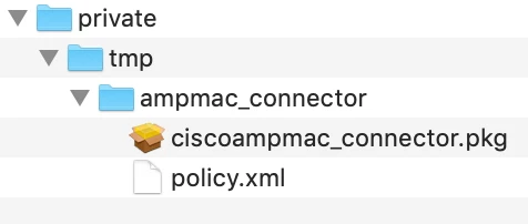

First, I created a folder in /private/tmp/ called "ampmac_connector"
I then located and copied the hidden .policy.xml file using Terminal, from the mounted disk image into /private/tmp/ampmac_connector/
cp /Volumes/ampmac_connector/ampmac_connector/.policy.xml /private/tmp/ampmac_connector/policy.xml
Note that in the above, I'm renaming it without the leading period. I'll explain why in a sec.
Also copy the .pkg from that mounted disk image into the same /private/tmp/ampmac_connector/ location. You don't need Terminal for that. Just copy it in the Finder.

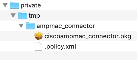

Now open Composer, close out of any dialogs asking to create a new package if that comes up.
With the Finder open to /private/tmp/ drag that ampmac_connector folder into Composer's sidebar. This should create a new source. Initially it will take on the name of one of the folder, so rename the source to something else if you like, such as "Cisco AMP" or whatever makes sense for you.
Now, in Composer itself, turn down the folder disclosure triangles so you can drill down into /private/tmp/ampmac_connector/ in it and reveal the files that were copied in. It should look something like this:
Click on that policy.xml files name, and when it highlights for renaming, add the leading period back in the name. It should now look like this:
If needed, you can change the permissions on the files to make sure they are fully readable by all accounts. They should be ok as is, since it was copied in from the /tmp/ directory, but best to check them just in case.

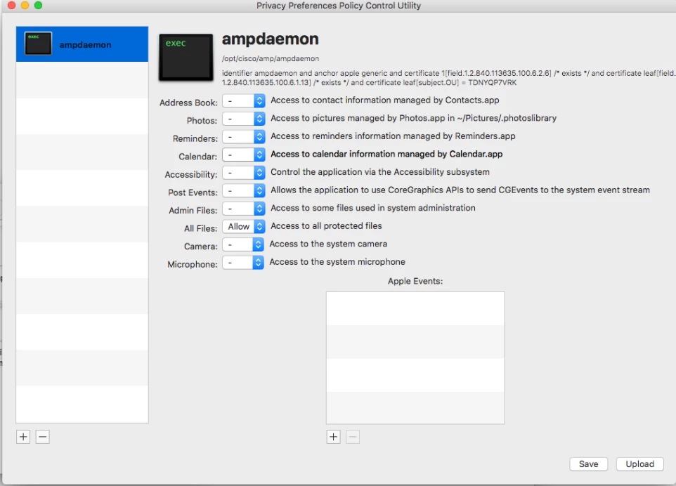

  • June 7, 2019
@mm2270 This workflow for distribution worked great for me as well, thank you for this step-by-step!
Prior to this auto deployment and installing manually on a machine I had to create a new configuration profile with 1) Privacy Preferences Policy Control to allow full disk access and 2) Approved Kernel Extensions in order to grant AMP access in Mac Mojave. My prior configuration profile worked and after the manual install, there was no further action needed.
After this deploying this package though, AMP is no longer has the kernel approved access. Full disk access is still working with the ampdaemon identifier, however approved kernel extension is no longer working with the Cisco team ID: TDNYQP7VRK. AMP still wants the user to manually approve this kernel extension.
Does anyone have a configuration that works for providing AMP the access it needs using this package distribution method?
EDIT: Not sure why it worked prior, but all I needed to do was add two more bundle ID's in the approved kernel extension configuration: 'com.cisco.amp.fileop' & 'com.cisco.amp.nke'

@robstratton What does your PPPC look like to allow full disk access? I am very new to this and I am trying to learn how to configure this to allow AMP to work for us.

Also for PPPC, i used https://github.com/jamf/PPPC-Utility to
create the configuration profile then uploaded to Jamf.

So how. do you handle the blocked extension?
  • June 3, 2020
You'll want a configuration profile with a Privacy Preferences Policy Control
and a Approved Kernel Extensions.
geoff_widdowson
@Echterling This is what my configuration profile looks like. My deployment is based on this post and its working fine.
  • December 14, 2020
@geoff.widdowson Thanks for posting the screenshot, that was extremely helpful. One quick question, and forgive me if it's a simple answer, but in the Privacy Preferences Policy Control tab, under Code Requirement, where do you generate the text from? I am still pretty new to JAMF and I have learned a lot on this thread.
EDIT
After looking into it, I see the PPPC generates it. I must have missed that on my read-through... Thanks again for the great info.
  • December 15, 2020
To anyone looking at this going forward, Cisco changed how AMP interacts with System / Kernal Extensions. Please see below https://www.cisco.com/c/en/us/support/docs/security/amp-endpoints/216089-advisory-for-amp-for-endpoints-mac-conne.html
It will show what to approve based on your OS version. It also provides the details needed to set up a socket filter (under the content filter tab)
